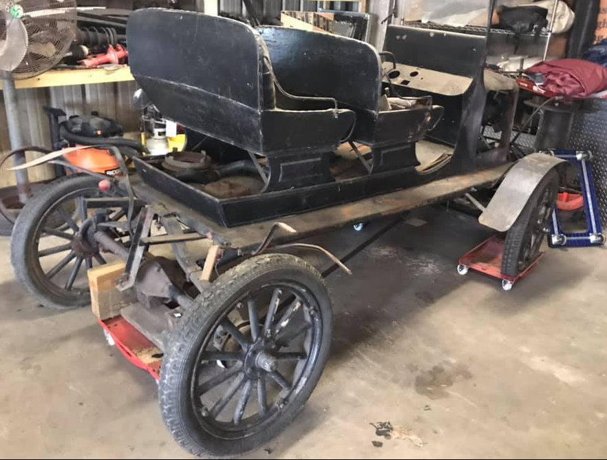

what is this car? trying to id
Post by Dave Foley » Wed Nov 10, 2021 12:24 pm
said to be a 1904 any thoughts
thanks for your input
Dave

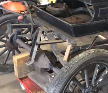

The rear axle and spring look possibly to be Ford.
The rest kinda looks like a conglomeration and some parts homemade. Does it have an engine ?
More pictures might help.

Looks like about a 1915 Fordsleigh. More pictures from different angles would be helpful.

Not a real car, made up of random parts including a buggy, model t parts, and who knows what else parys.

A pastiche. Model T wheels 1919 or later, being demountable. The rear axle is not Ford T. The seats are most likely from a horse-drawn vehicle, as well as part of the "body" they're sitting on. No telling what's up front, really nothing "1904" about any of it.

Look at the relationship between the left rear wheel and the axle. If that wheel is mounted, it either has some kind of doodlebug reduction gears or it's a clown car with the wheels mounted eccentrically. It's an interesting item, and may have some interesting parts in it.

Definitely something interesting about the rear end. If there is anything 1904, it would be the buggy seats.

If anyone said it’s a mutt or a mongrel, it would be an insult to mutts. The wheels are just sitting near the axles, nothing to do with model T or any other car as far as that goes. The kindergarteners had a great time putting it together.

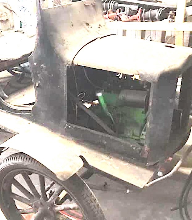

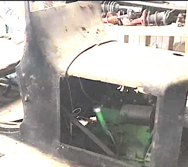

It seems to have motor, green one. But the whole thing is sitting on angle iron framing.
Certainly never ran in the shape it is in.

Cowl and dash are very interesting. Might be a mutt, but it started from something!

I believe that hood is from a portable power unit. The engine may also be. It looks like a Continental or Hercules or one of those type engines. The horse era parts may be valuable and the wheels look worth saving. I'd want to know what all the parts were before I tossed anything out. The seating could be used for a nice T-based parade vehicle. The cowl is an odd looking piece.... could it be the left and right rear portion of a late T roadster body welded together at the bottom edges and stood on end? Nah... it looks more like part of something like a late 1930s coupe, perhaps the area behind and below the rear window and ahead of the trunk opening, or the same area off a late T coupe.

The pumpkin/differential is definitely interesting, unless I'm not seeing it right. As for the car itself, I'm looking at it for what it started from. I can see what it isn't.

Rear cross member cut off, looks like a square block stuck inside the rear axle differential housing.
Cowl would be good on a speedster - besides the buggy seats, it may be the only other thing of value
Is that the steering shaft for right hand drive? Generator , dip stick, oil filler

Thanks for the input, a friend had sent me the screen shot, its on facebook in vero beach florida and there's a couple more pictures there, haven't seen the car in person, thought the tiller steering was interesting
