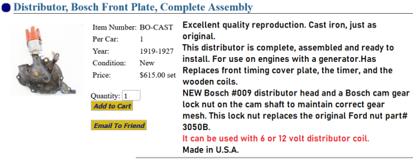

The distributor body may be able to work on 6 or 12 volt. Its the coil that is matched to the car voltage (battery). So all you may need to do is use a 6 volt coil. What model distributor and does it have points? If it has an electronic ignition module setup then it is voltage dependent for sure. Also is the coil a 12 volt - check the model # and does it require a ballast resistor? Hard to give a definitive answer without knowing what you have - generator or alternator etc
Here is an example - so what do you have?

Pertronics make all kinds of distributors so you can't assume that its a VW/Bosch or a Delco clip on or whatever. Need to know a model number, picture will help as well.
While we all agree that you don't need 12 volts, we also don't know why he says its 12 volts or has it.
"My 26 project came with a 12 volt pertronix in the distributor but I would love to run the rest of the car on 6 volt to protect the starter. Is this even remotely possible?" note the first words "My 26 project came with" doesn't say what else it came with.

Thanks for all the input guys. I have the Texas T conversion with a 12 volt pertronix electronic in it. It is a Bosch 009, so I think I will just buy the 6 volt version of the pertronix, a 6 volt coil, and call it good. I don’t have a generator yet, but that is what I’m going to run. I tried pulling my gen apart to rebuild it but for the life of me cannot get the pin to budge that holds the gear on. I’ve tried to drive it out from both directions thinking it might be a tapered pin but no luck. It looks and feels like it might have spent the last 30 years in the bottom of a swamp, the only usable parts might be the case and gear. I would like to just buy or trade for a rebuilt one.
