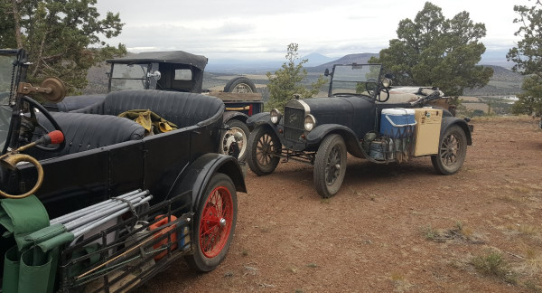

I have been running 525/21's for years on wood and wire wheels and I love them, the Firestones are a little taller than some of the others and they are 6 ply rated, I also like that there is more tire on the ground for braking. It takes a little bit to get used to the "Hobo overdrive" and if you don't have a Ruckstell you will be in low more, I run 36psi on my roadster (it weights about 2600 lbs when loaded) and 20psi on the Funster.

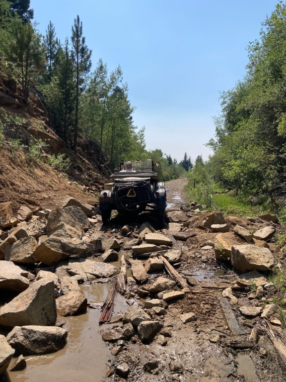

A friend went with the Lucus 525/21 tires and they are about 1/2 in shorter than the Firestones and he didn't get very good wear out of them. I average about 35,000 to 40,000 miles out of a set of Firestones and there is still some tread left and I tend to torture my tires more than most.
