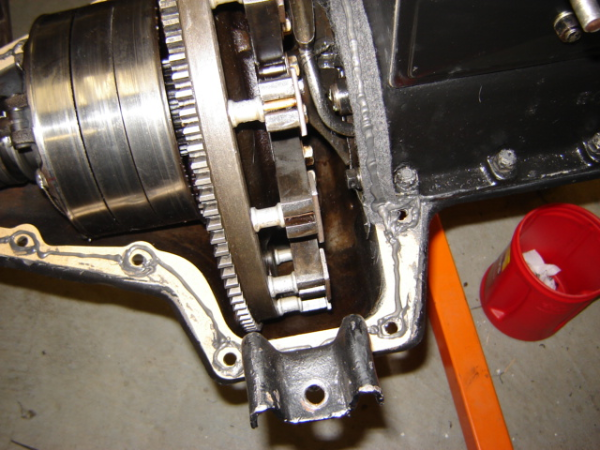

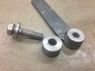

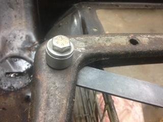

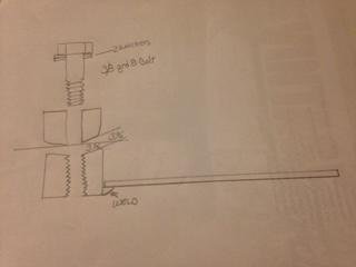

This is a tool I made to flatten the dimples in the pan from multiple attempts to stop leaks. It can be used when the hogs head is off.
dimple tool #3.jpg (12.54 KiB) Viewed 3881 times
dimple tool#2.jpg (13.25 KiB) Viewed 3881 times
dimple tool.jpg (4.82 KiB) Viewed 3881 times
Craig.

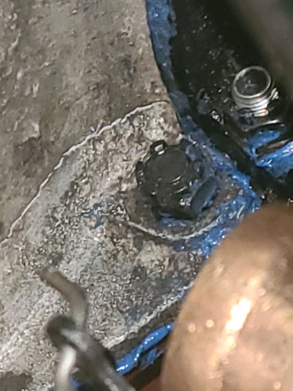

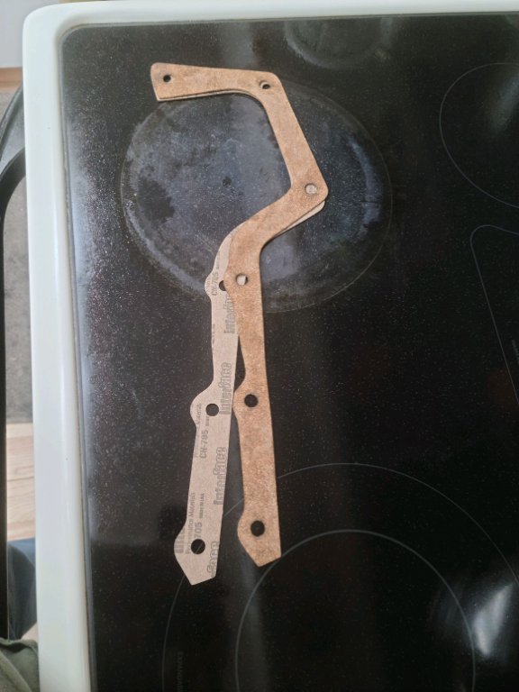

Post by Nv Bob » Sat Nov 20, 2021 11:37 pm
First each set of gaskets ordered in 2021 from 2 main well liked suppliers I used for years
So make sure you get good ones
Nv Bob
Posts: 799
First Name: Bob
Last Name: Middleton
Location: Western nv
Re: Setting the hogs head
Post by Nv Bob » Sat Nov 20, 2021 11:43 pm
Then if you unlucky you get to do it all over again
Practice my Impressions of a drunken sailor
Yes it's repairable but luckly had another one

Post by speedytinc » Sun Nov 21, 2021 9:53 am
Nothing "unlucky" about this, except that you had another one.
Since you took the effort to show it, for the benefit of others, as a teaching tool of what not to do, I will point them out.
1) information on the fragility of early covers is well known here. A quick google on the subject will bring up a detailed explanation of the improper thickness of the felt in relation to early hogs heads. (Original Smith) You can get away with it on the more forgiving iron covers.
2) Not any silicone is acceptable. This blue, clear, windshield or window caulk will not stand up to hot oil. Ultra black or silver will.
Those extra blue beads will soften & give your motor a case of intestinal worms. Congregating in the oil funnel. You wont know until you starved a rod.
A transmission screen may or may not add to the life of that rod.
3)Pulling down the HH is a "gentile" process of back to front. GENTILE.
4) A 110 year old, increasingly harder to find cover managed to survive, only to be permanently scarred or sent to scrap In an age where a few key strokes could have saved it.
I sincerely hope others will learn from your experience. No offence intended.

Post by Nv Bob » Fri Nov 26, 2021 11:02 pm
No offense taken but many T I've built have had zero issues with blue RTV
And I've owned 39 Ts to date and worked on mny more
But with the alloy hogs head one needs to be more careful in this gap area
My other hogs head went down like it was supposed to
Hogs head in the pics already been repaired and waiting
Used a pattern to bolt it down
