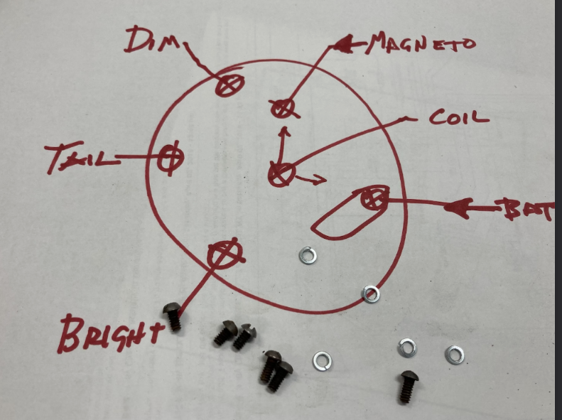

Working away on the ignition switch wiring but have derailed myself.
I removed all the wiring screws but putting them back in the correct places is a problem.
I didn't realize that they are two different lengths so now don't know which what goes where.
Any hints on where longs and shorts go?

I guess the answer might depend on your wire connection thicknesses and switch backing plate (original?). Likely the screws were replaced at one time but as long as they don't go all the way through it shouldn't matter. The BAT connection might need a longer screw because of the brass link but all the rest, the same. Your pdf show 6 screws and 5 lock washers

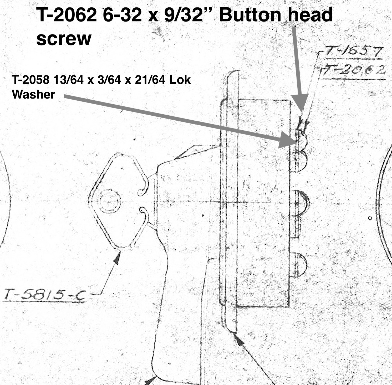

Factory print detail of part numbers for the wiring screw and lock washer used on the ignition switch.
Sizes from parts book price list complied by Bruce McCalley.

Great to see that the picture got posted. I've been trying all sorts of sizes and formats to figure out how to add the picture. Thanks for posting what I was trying to explain.
I did put out only 5 lock washers....there's another one around here that will be added to complete the team.

While they are different lengths, Dan's detail shows 9/32" as the correct original length, so I'll head that way.
