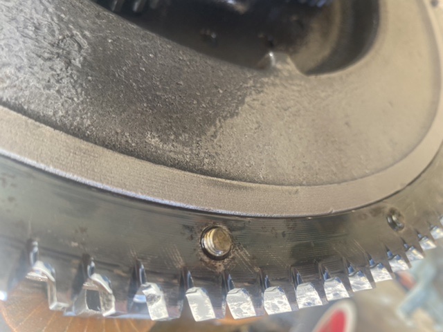

Thank you for all the reply’s and help. A few minutes ago I took another look at the transmission screen after the run this morning and found a mangled piece of brass screw head so chances are a magnet keeper is amiss.
Anyway engine and transmission are coming out starting next week……

Due to time constraints, my age and awful lower back problems I last week decided to let someone else take the engine and transmission out of my ‘25 Coupe to find out what had come loose.
Sure enough the culprit was a magnet keeper that had come loose but since I turned the engine off right when I heard the metal hit the inside of the hogshead no other damage was done. Oddly enough whom ever rebuilt this engine some 20 years ago did NOT peen the ends of the brass magnet screws…..
