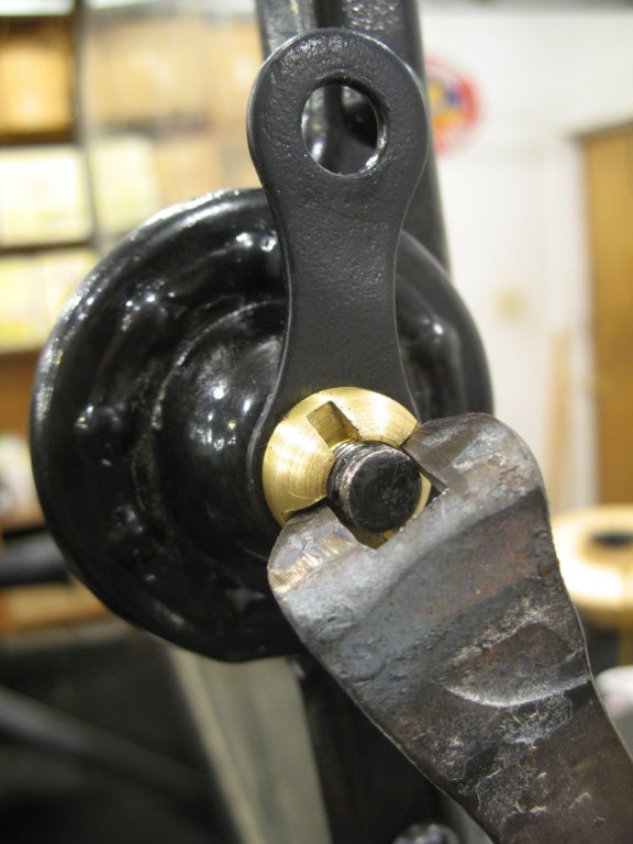

- Posts: 7381
Re: Upper half of windshield moves a little bit too easily
That 15-16 nut takes a special wrench. You can easily make it yourself.
Thanks for this hint.
According to the picture: My hinges have normal Crown nuts, secured by a cotter pin. But all the rest looks very identical .
I was asking because the metal part (where the hook for TOP belt goes in) is already very hard to rotate, so I thought there is no further tightening possible.

- Posts: 4580
The hinges are adjustable. If the hinges haven’t been lubricated in a while spray them with WD-40 to lube them then back off the adjusting nuts some and move your windshield up and down a few times. Then adjust the nuts so you can drive the car without the windshield tilting back.
I have a 1919 Touring without a top and I have the windshield adjusted to where it is secure but still can be tilted back in different positions.
The hinges are pretty simple and not hard to adjust, dissemble and work on. If you take them apart, clean them up and use a light coat of grease inside them. Once you take one apart you can see how they function and see how they work.
The hinges have dimples pressed into them. The outside hinge has the dimples outward while the back hinge side has the dimples pressed inward. That is what give the adjustment for the hinge tilt or going straight up. The spring and nut hold the two halves together and the tension is given by the spring and nut pressing the two halves together.
