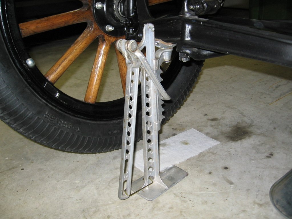

I will do almost the same as you do with your tire savers, but I will use such supports instead:
I will use this supports
They provide a better stand (important because my grandson is often around Lizzy). So he can get in/out Lizzy without any risk.
In addition, they are for sure lots cheaper. Your ones look really wonderful, but safety first. :)

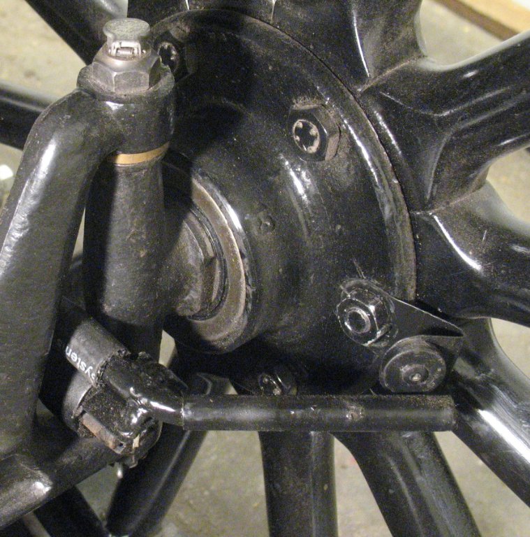

This magnet will be used by my tachometer.
Rather than drill into a spoke, you can use one of the hub nuts to attach the magnet
BUT I should warn you that your tachometer setup may be doomed to failure. I used, or tried to use, a bicycle speedometer for several years. The sensor and magnet arrangement you see in the photo was one of many attempts to make the bike speedometer work long term. Everything failed. I even tried putting the sensor and magnet inside a rear brake drum where I assumed it would be safe from road hazards. Like all previous attempts, that worked for awhile and then quit. I never finished a trip with the speedometer working. I have a Model T era speedometer I will restore and install, and I intend to back it up with a GPS navigation device. After multiple failures, I'm not wasting any more time on a magnet/sensor system.

This is really a nice setup. Almost invisible. - Thumbs up!
According to the difficulties you experience... I am not really surprised. The major problem are buzzer coils and spark-cables. They cause horrible EMI (electromagnetic interference) from inside the coil box (its back and bottom side is wood, no steel) as well as spark plug cables, and the cable to the sensor is for sure not electrically shielded, too. I would really wonder if a bicycle speedometer can reliably operate in such environment as a bicycle has absolutely no EMI at all.
Therefore I use a shielded cable (all wires inside a copper mesh tube) to the left-rear wheel, to get as quick as possible far, far away from all this EMI noise source. This metal mesh is connected to car chassis ground and catches most of this noise. I also implemented electronic filtering and protection to block all the noise approaching through the cable.
It will help you for sure, too, if you replace the original bicycle tachometer cable (only two wires side-by-side) by such shielded cable. Depending on number of wires used in this cable, a shielded stereo microphone cable (two wires, each one in a separate copper mesh) should match your needs. Twist the meshes on one end to each other and connect them to the car chassis ground. Leave the other mesh ends open! Then use the inner wires for the sensor, but keep the unshielded wires as short as possible (less than 1").
Current status:
  • The cable is installed and connected to my "dashboard computer", but the sensor is not mounted yet.
  • So the cable already will receive all EMI noise, but I had not a single triggering pulse (would cause a displayed speed) yet. In other words - my filtering seems to work.
  • During next week I will pure the sensor in EPOXY to make it waterproof. Then I can mount it.

Sadly I cannot upload a video, only pictures, here. So I placed the short video on my own WEB server. Please ignore my german language comments, I sent this video before to a friend and I explained to him verbally...
Here is the link:
http://www.hantsch.co.at/_temp/unfinish ... ometer.mp4
The sensor shown at the very beginning will be mounted in a distance of 1/2" to the left rear AC brake. There it is almost hidden between all this steel rods and levers. I use a magnetic bit for manually generating magnetic pulses for demonstration - as the wheel will do in future (one pulse per revolution). The measurement has the precision of 1 km/h (kilometer per hour) and is updated every second. Later I pan to the display and show how the speed is displayed.
Well, this video will not win an oscar, but it shows how it works. It was a bit difficult to move the magnet and point the camera at same time to the display.

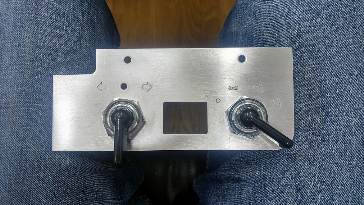

And this is the dashboard:
My self built dashboard
My Lizzy is left-steered, so the dashboard is made to fit into the left edge below windshield. You only see the rectangular area while both ears (top and left) sit behind the body. The former owner has drilled a mounting hole for a light switch into the metal profile below the windshield, so I had to re-use it. This finally led into this mounting location. :?
The left rotating switch is for direction lights, the right one is OFF-Parking light-Low Beam-High-Beam.
I think this looks better than a chromed direction light switch on steering column + pull-switch hanging down below the windshield for headlights.
Rainer
