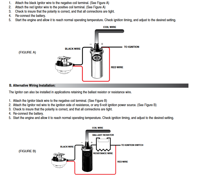

Pertronix 45011 Flame-Thrower II Ignition Coil, 6 Volt, 0.6 Ohm
Info
The hotter the spark, the easier your engine will start, and this 45,000 volt coil is just the ticket to a quick start! Has 0.6 ohms of resistance. Black case for a stock look.
6 volt coils can be used with 6 volt point systems. If used with 12 volt point systems, it should have a 1.00 OHM resistor added.
Item Details 0.6 OHM Resistance
Installation Tips
!Caution: Flame-Thrower II 0.6 ohm coils should NOT be used with the (original) Ignitor or point type ignition system. Flame-Thrower II coils are compatible with Ignitor II ignition systems, and most capacitive discharge (CD) systems that control the dwell period, or limit the current.
Just an example...
No most coils are designed to work at about 6 volts input. 12V cars use resisted inputs or internally resisted coils (usually clearly labeled as such) to keep the coil from over heating. Some starter solenoids, like ford 12v have an unresisted terminal that feeds the coil 12 v while the starter is spinning. theory is to give a hotter spark while starting the engine. Then when the key is released, the circuit goes through the ballast resistor or the resistor wire.
So a 6v car will run on just about any coil you mount that is not labels as internally resisted. The resistor in the 12v system usually operate the coil at 7 or 8 volts.
The important thing is to assure the coil is wired properly for the grounding system of the vehicle. Most vintage/old 6V were positive ground. so from ign the wire should go to the negative coil terminal and the positive terminal to the points, where the circuit gets grounded to positive when the points open. Opposite for negative grounded circuits.
As a point of reference in regard to resistance, it is the most usually reason why 6 V systems do not operate as designed. Any resistance in a circuit kills the electrical flow (amps) which 6 V system depend upon for proper operation. The most usually place is a corrupted ground after the load or loose or corrupted connections in front of the load.
The other most usual suspect is that the #1 gauge or thicker main battery cables have been replaced with the wimpy stuff 12V likes , and the ground strap from the body to the frame or engine is missing. One reasons that manufacturers switched to 12V is that they could half the gauges of wires used in the vehicles circuits. Saving weight but more important saving money.
Info
Installation Tips
Just an example...
