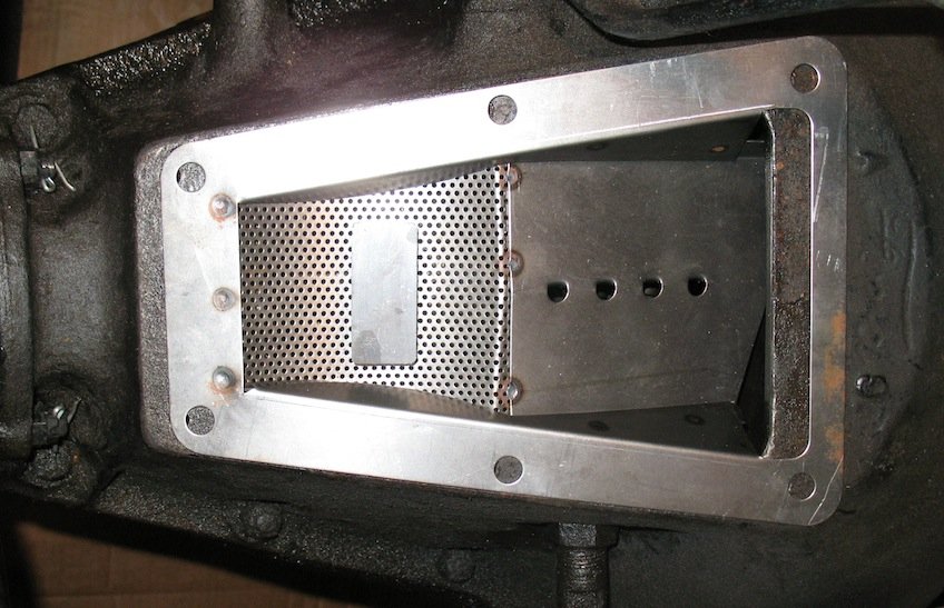

Modified screen vs unmodified screen.

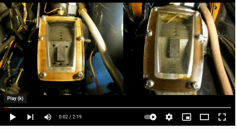

My choice is the unmodified screen. Drilling the holes in the screen portion doesn't cause any more oil to flow over the bands and allows nonmagnetic junk to circulate. Once the unmodified screen fills up the screen portion, all additional oil is distributed over the bands
https://www.youtube.com/watch?v=dXimnKoDPSI

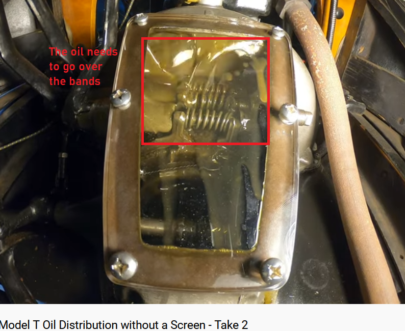

The video of the unmodified screen - one could argue the benefit of enlarging the holes in the most forward position of the screen, need to remember that the transmission drums are rotating in a bath of oil
https://www.youtube.com/watch?v=I1w2vFTRUvQ
