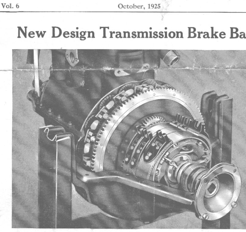

I have a 1927 roadster pickup. I am installing wood bands. The bands shown for a 1927 has one wide band. All 3 bands in mine are narrow. Can I cut the wide wood band down to size. It will still have the oil groves. My motor number is 4042906. Is mine not a 27 roadster? Has engine been changed out? Did some 27s have all narrow bands and some one wide. The band so have the removable ears. (FYI) I let one on the band slide around too far so I had to remove the hogs head.

I recommend getting the correct brake band and not cutting it down.
If you cut it, the rivets and ears won't be centered anymore, unless you cut both sides.

The wood band is all that would need to be trimed. The wide wood band had 4 oil groves, if I trim at the 2 outside oil groves the inside 2 oil groves matches perfectly with the other 2 wood bands. All 3 steel bands are the narrow ones. When did Ford change to have one wide band?

The "Improved" 1926 (& '27) Ford had the new, wider brake band.

Change to transmission brake band Aug 1, 1925 for the Improved Car.

You ordered wood bands based on the year model of your RPU and not engine/tranny. Yes your engine has been changed out and no; Ford didn’t make ‘27 models with some 3 narrow bands and some 2 narrow and one wide. Toward the end of Model year 1925 Ford introduced a wider service brake DRUM necessitating a wider brake band and slightly modified tranny cover. Some call it a hogshead but here in south Texas tamales are made from hogsheads. Simply get a 3rd narrow band - they’re proliferating in our garages - and call the wood band maker and buy a single narrow band....
