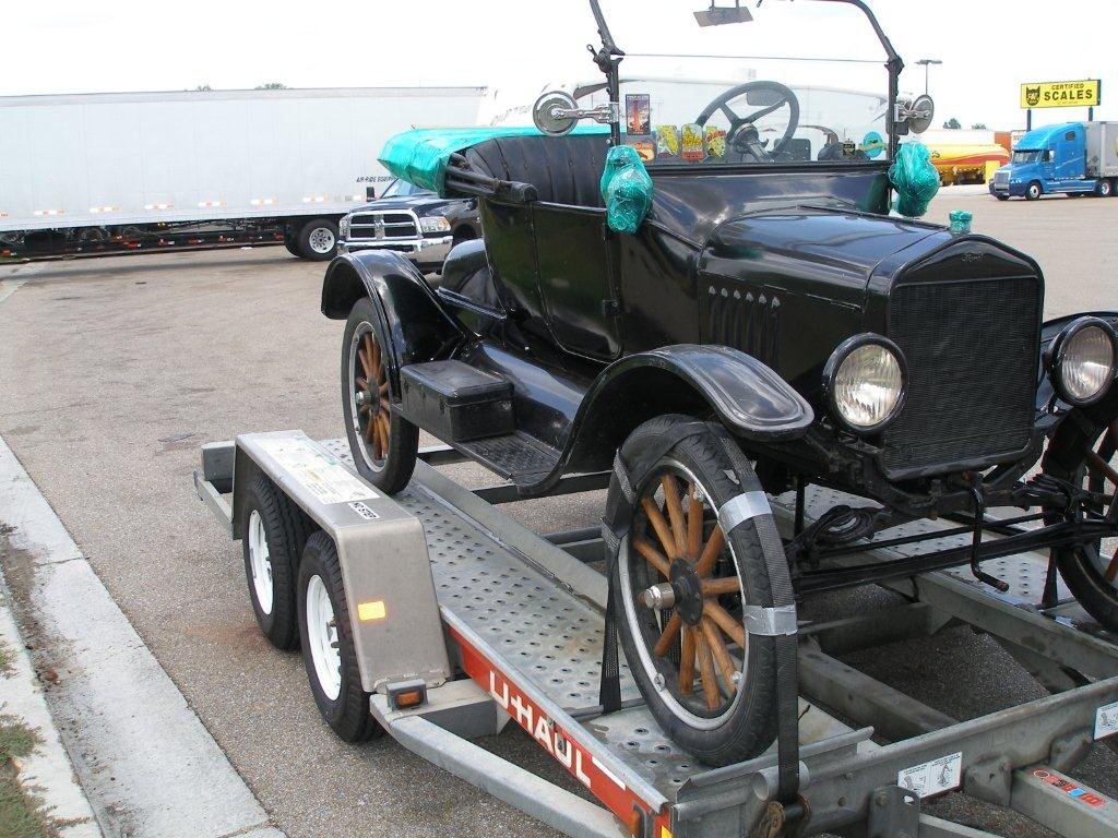

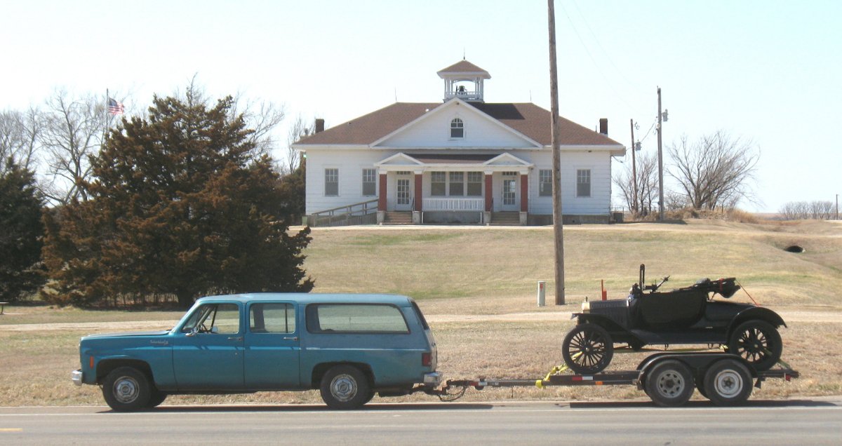

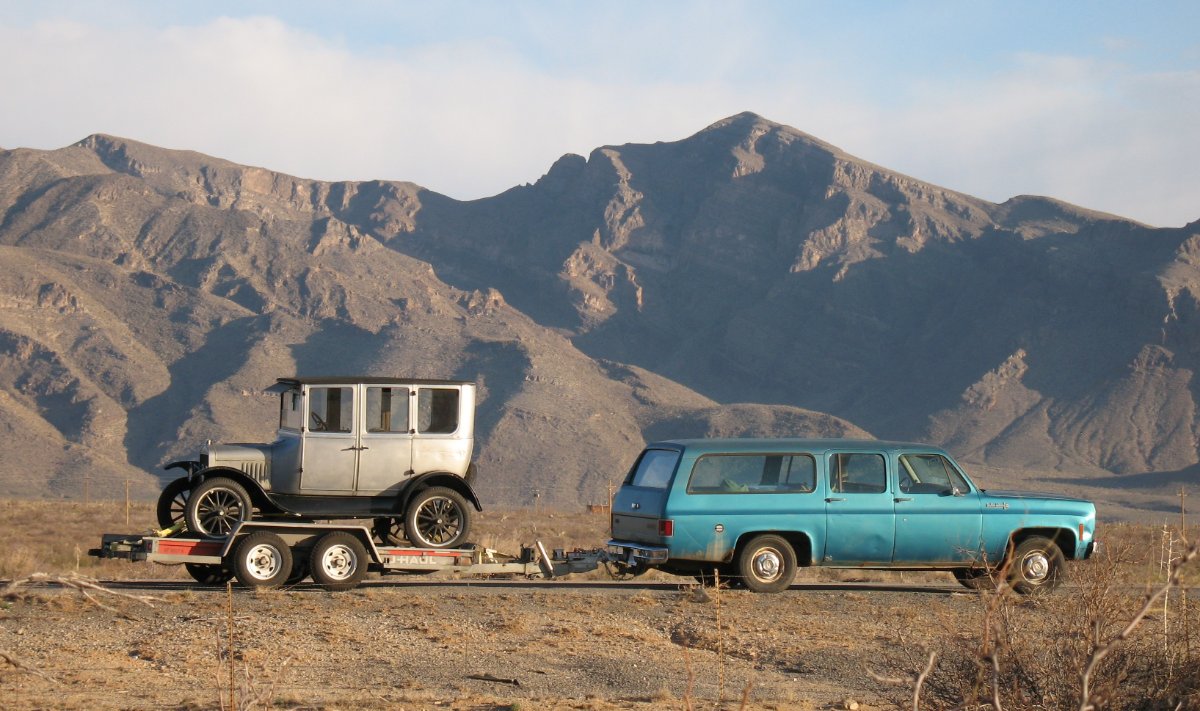

No law says you have to drive 70 mph. I have always used an open trailer, and I have observed my own 55 mph speed limit. The transported T has always arrived unscathed, and my gas hog Suburban has escaped descending into single-digit gas mileage.

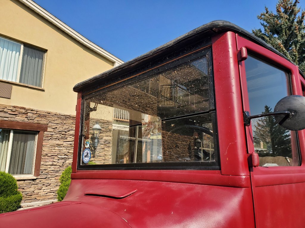

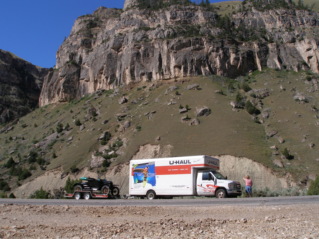

I have hauled my Ts all over the West with visits in Elkhorn.
Bugs have been my biggest issue.
Worst case as far as the windshield is concerned is a $100 replacement at the local glass shop.
Below picture Taken in Idaho Falls this summer. Look close you will see lots bugs.

Note on above pictures that the upper part of the windshield is either partly folded back or completely folded back.
Note also, that there are folks, which on stock Model T's drives around 50 mph in average over 3 days (Montana500) and have no issues with the windshields.
So 55 mph is probably the speed to go.
