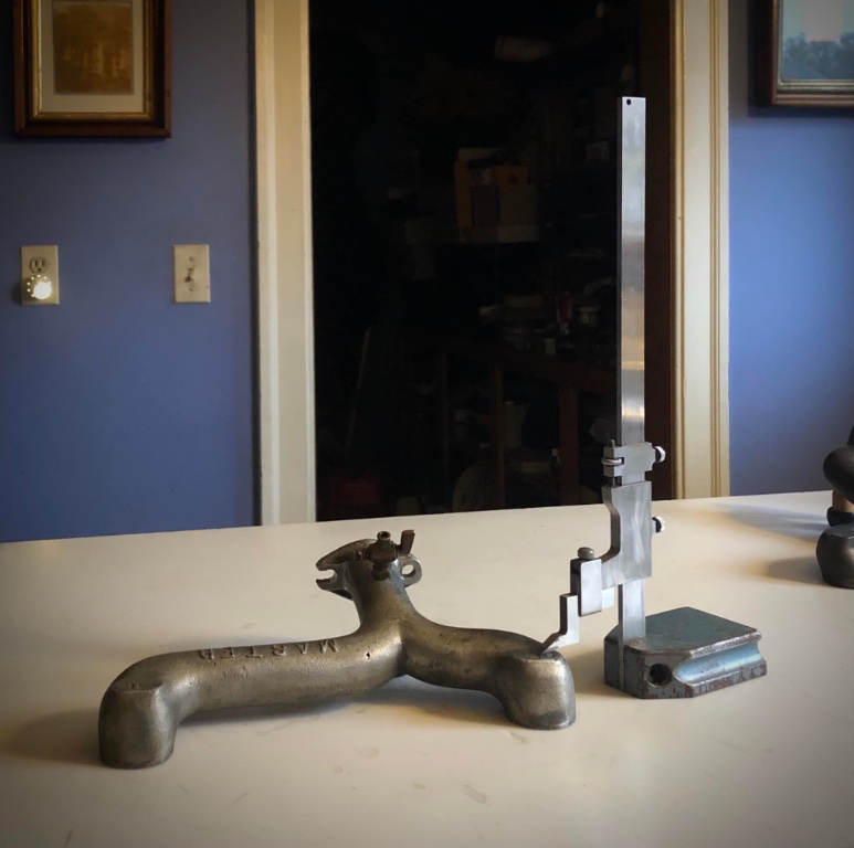

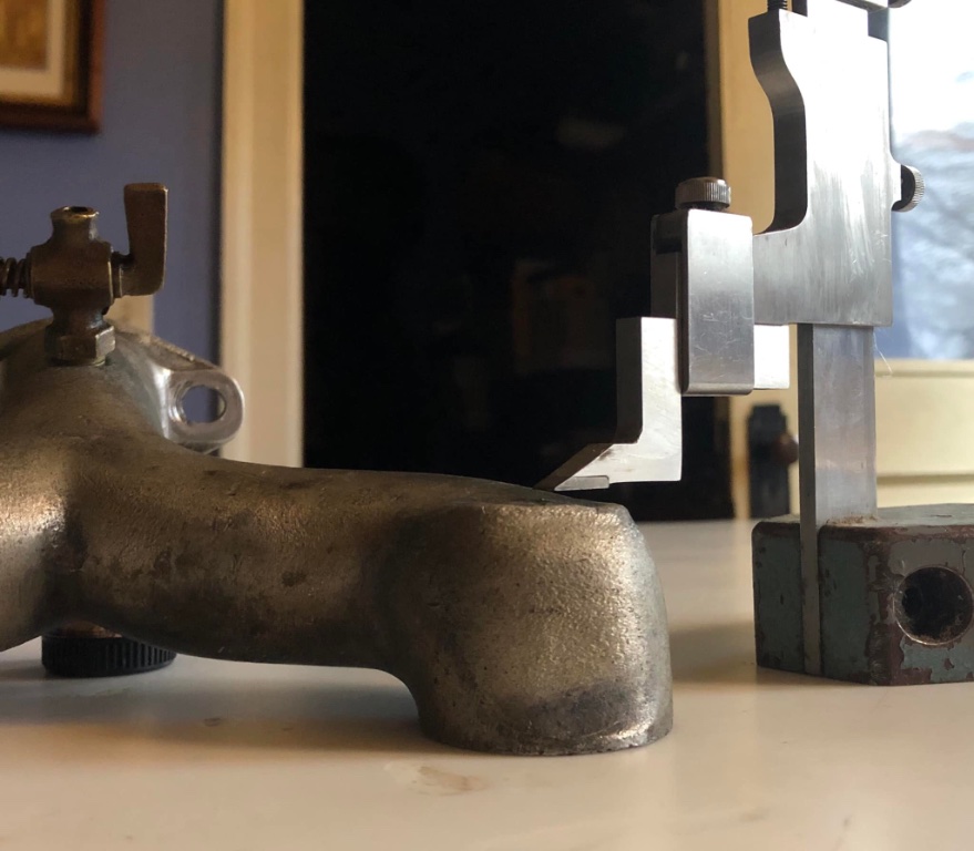

I am getting ready to install the Master Carburetor in my T and am trying to decide how to fix the aluminum dedicated Master intake manifold. One of the bosses on the manifold is worn / crushed and I’m faced with the choice of building it up with an Alumi-weld rod, JB Weld or using a shim. It’s the difference of 1/8” - 3/16” that needs to be filled to make it the same height as the other boss and that on the exhaust manifold.

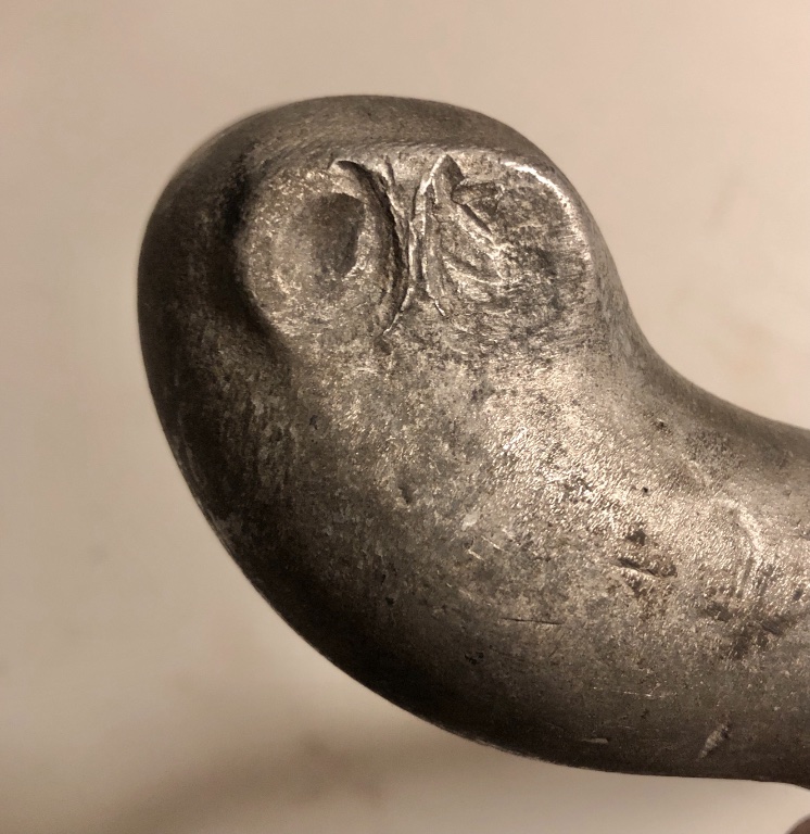

John, That would work and I understand the reasoning but I don’t weld steel and I think that would be the way to go if building up the clamp. But there is another thing. The boss on the aluminum manifold is actually crushed in a little. See the picture below. I think it might be important to fill that void and build up the area in case the metal is thin.

If it were mine, I would not be applying plastics or alloys to the manifold; I'd be taking it to a welding shop and let them build it up and then dress it back with my mill...and in the absence of a mill, then with a mill file and emery paper

Scott … sounds like the best idea.
