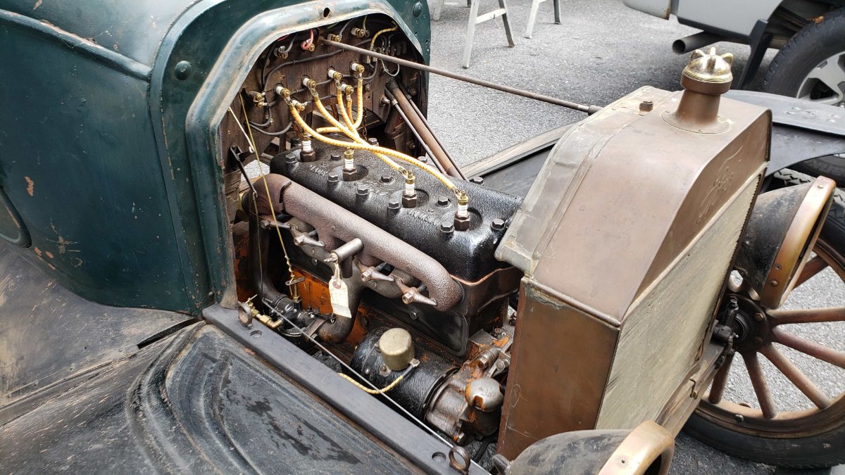

Kind of hard to see here but my choke rods are just old silver coat hangars. Works really well for the choke. On the other hand, not good for the carb needle adjustment. I shaped that out for an actual rod. Ha!

If you do not know what that pipe is that is sticking out of the exhaust manifold and would LIKE to know, send me an email (I don't want to drift this thread)

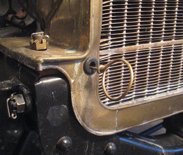

Here's the front end of the choke wire I made for my 1915. For the brass era car I used incorrect 3/32" brass welding rod and wrapped it around a deep socket as Larry says. The material used in chorke wires changed several times. Correct for my 1915 would be copper coated steel. For my black era car I used 3/32" steel welding rod. A more recent picture would not show a rubber grommet in the hole. It doesn't take long for those to wear out and fall off.

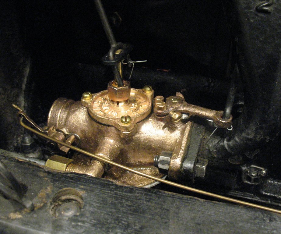

Here's the back end of the wire as Scott described it. No need to unbend anything.

I would put a brass flat washer under your radiator mounting stud to keep the nut from messing up your radiator side panel.
