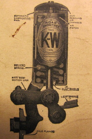

Are they able to be disassembled? I have a set on the back of my car currently and would like to know if the spring cover/cylinder can be removed. I thought maybe it was screwed on but I don’t want to destroy them. I’d rather remove them and put them on the shelf then destroy them.

The shock cover unthreads and can be removed to clean or relube.
The KW shocks are a beautiful looking shock with a nice brass nameplate. I would have no reservations using them. There is one design of rarely seen aftermarket shocks that caused a death years back, most common ones are serviceable even if the shock absorbing benefit is questionable.
