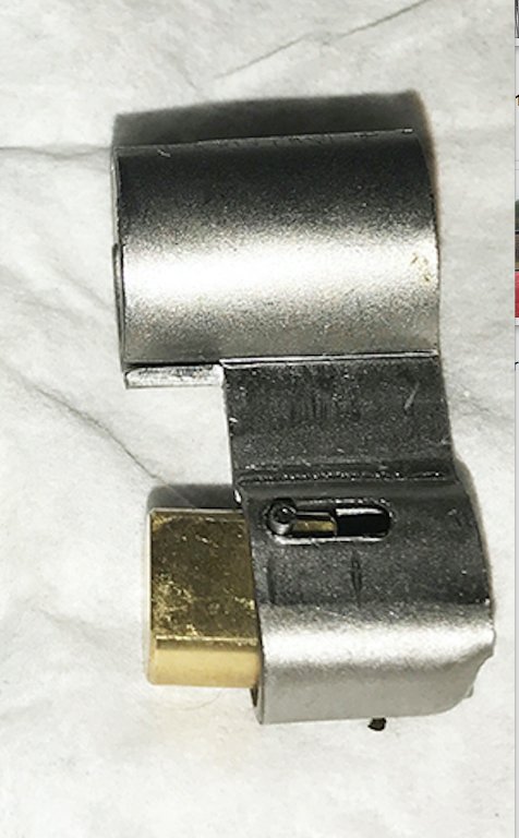

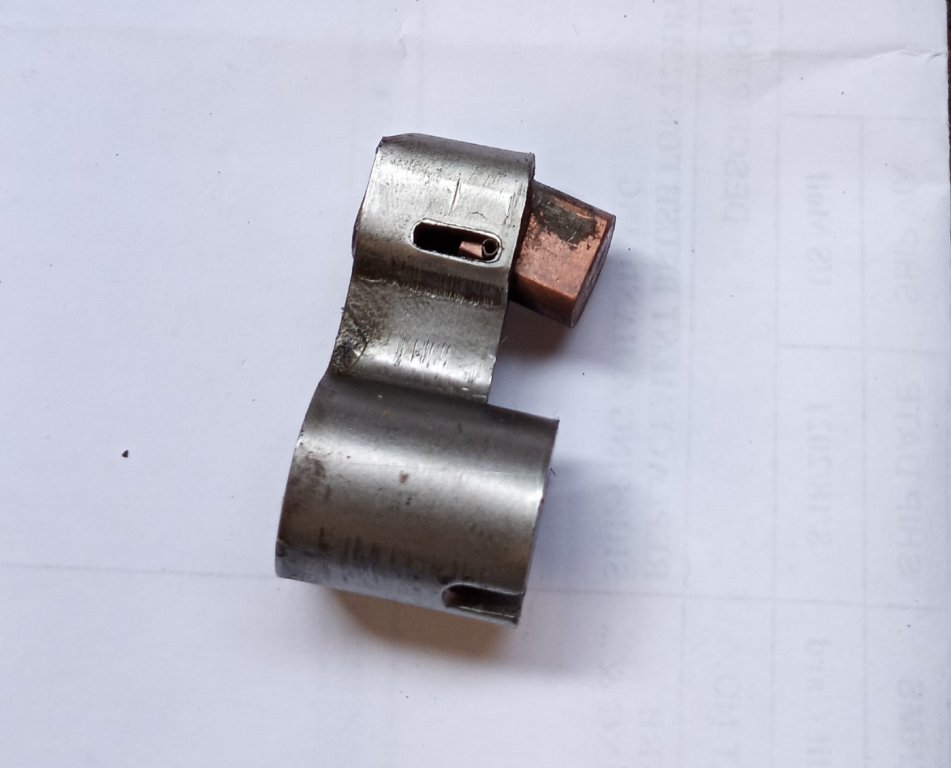

As the manufacturer of the "newest" New Day timer, I would like to point out, as I did in September when Tim Wrenn posted the exact same picture of a New Day brush, that that kind of brush has never been supplied with a Tip Top Timer New Day timer. Although Tim did not say that the brush came from a Tip Top Timer, one could infer that it had, since he says that it came from a new- New Day timer. We are currently making the newest New Day timers. To my knowledge, all of our customers are satisfied with the brushes that we supply with our timers.

This is the brush that came with my new "New Day" timer before I installed it. After 5100 miles it shows little wear and I see no need to replace it. I'm a happy customer.
For any New Day, old or new, just make sure the spring holds the brush pin against the top of the slot.
