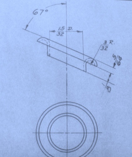

Here are the dimensions of that side curtain rod grommet, #45122X. They have an offset angle, so it fits flush to the top ledge of the doors which are angled. A straight sided grommet would need to be re-shaped or anchored in place with adhesive under the rim, after bumping it to an angle so it remains flush, hopefully the new grommet made of alum or some soft metal to reshape to fit.
Finding originals is tough, and most times the formed zinc part is distorted from years of poking the curtain rod in place.

Dan - thanks for sharing specs - was thinking of making some out of aluminum.

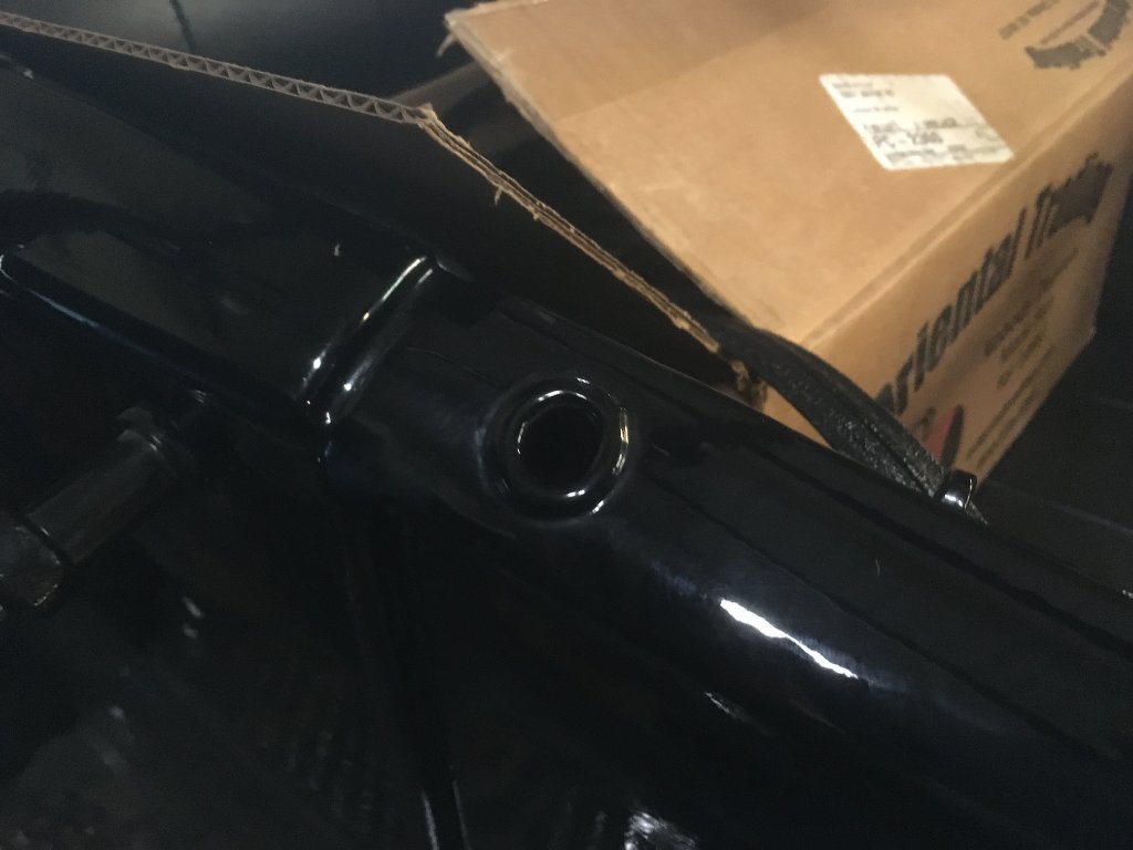

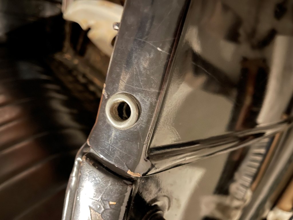

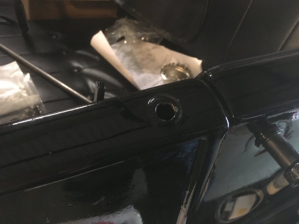

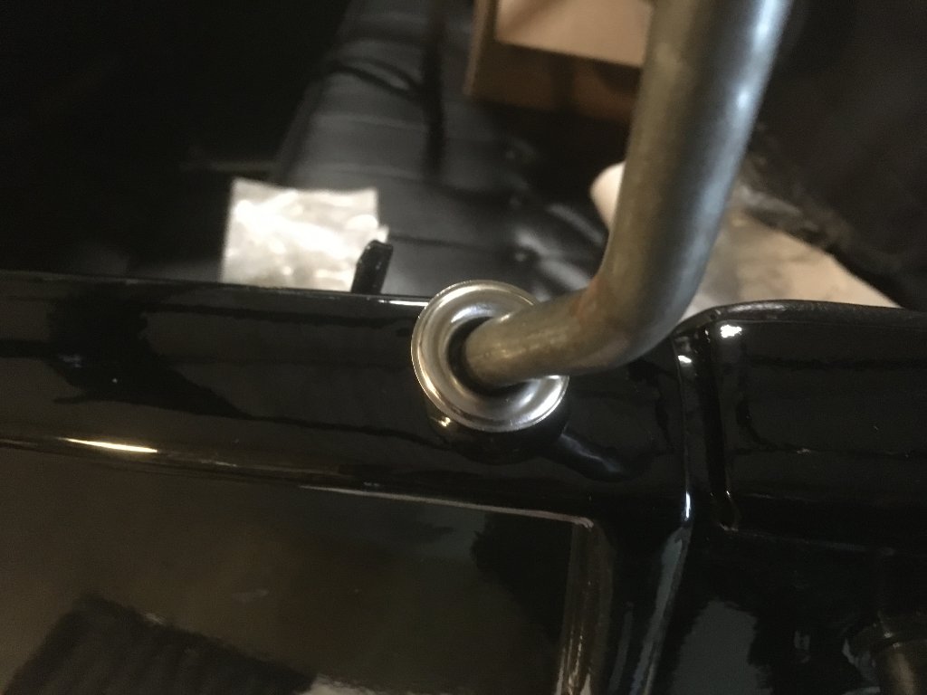

The Side curtain rod is 7/16" stock. The hole in an unswaged 7/16" grommet is smaller than 7/16" because the tapered press makes it larger after it passes thru the washer.
Here is an original Ford groomet on my 26 Runabout. Here is my reproduction made with brass telescope tubing. Here is a side curtain rod with a #4 (1/2") nickeled brass grommet. Note the rod fits the ID fairly close due to the taper of the grommet. Note the OD is much larger than whar Ford used. I hope this clarifies the relative sizes of the parts.
