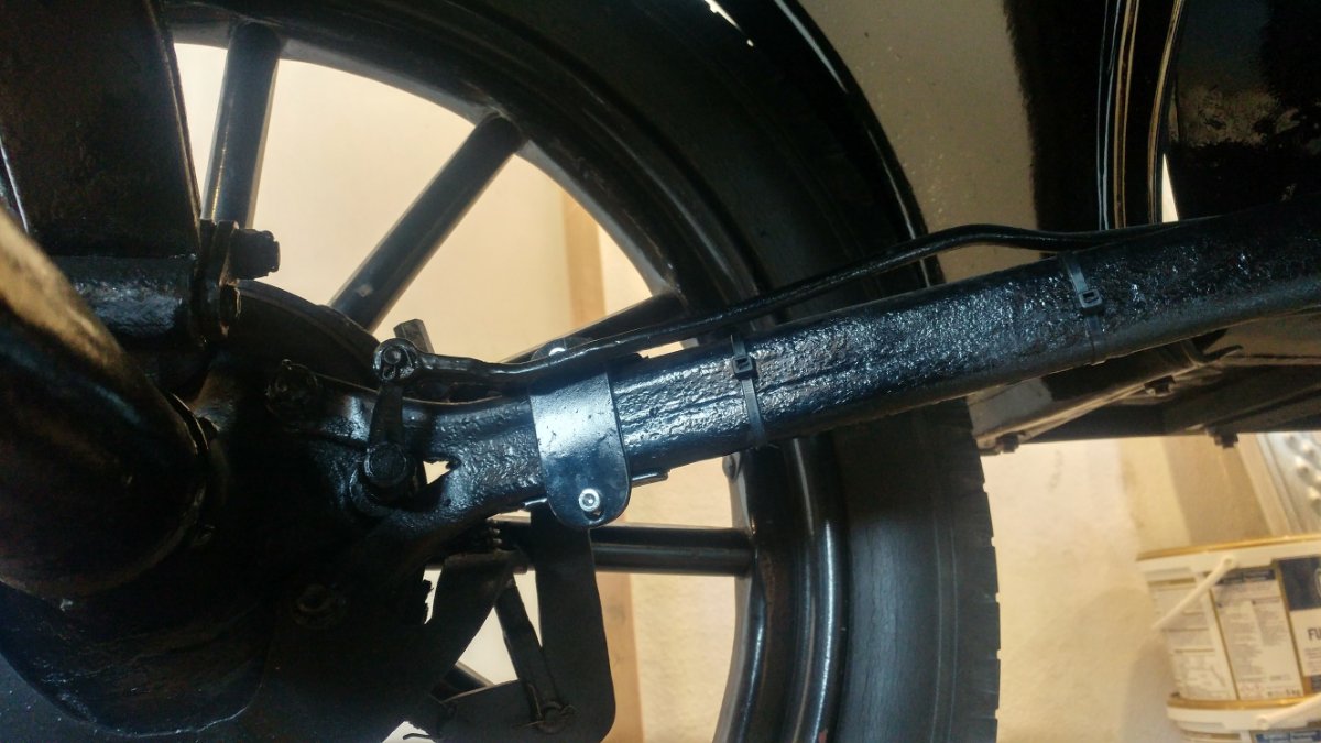

My car is a '16 Touring with wooden spokes and additional AC brakes (they work on outside of emergency rake drum, that ones).
This weekend I want to start building a holder for the Speed Measurement Hall Sensor. This sensor I want to mount at left-rear wheel, closely to the AC brake, in approx. 1" distance from the wooden spokes. To make it mostly invisible, it shall be located closely to the outer dimension of AC brakes and somewhere in lower region (between 4:00 and 8:00 position), so the brake is hiding it.
Idea 1:
It would be best when I could loosen one or both nuts from the diagonal stabilizing bar, coming from U-Joint and ending with its fork at the brake drum (no idea how it is named). Then I can put a piece of cut sheet metal over the threads and re-tighten the nuts. This sheet metal is the base for a piece of steel rod then. But I am scared that I will have to take off the wheel (and possibly even more) when the bolt needs to be held for tightening the outside nuts. Currently I do not have the tools needed to pull the wheel.
How is the situation here? Can I take off at least one nut, and tighten it again without access to the bolt head (if there is one inside)?
Idea 2:
Alternatively I think about making a clamp to the stabilizing bar itself. A clamp fitting to the shape of this bar, being tightened by 2 bolts reaching across the bar. I will weld a piece of steel rod to this clamp (pointing towards the wheel) and mount the sensor on its tip.
Idea 3:
I use a short piece of angle iron (1 1/2 or 2" every side) and 2" length. This will sit on the round/oval surface of the stabilizing bar. This iron will have two welded-on flanges with a drilled hole of 8 mm diameter. Then I bend a piece of threaded rod into U-shape. It comes from the other side (above and below the stabilizing bar), goes through the flange holes, and is tightened by two nuts.
As you can see, Every later idea is a simplification of previous one.
Any suggestions what will be the best way?

I think you are referring to the outer/rear end of the radius rods that stabilize the rear axle housings relative to the torque tube which houses the drive shaft?
Generally, attempting to loosen either of the two bolts at the back end of the radius rod without first removing the wheel is a very bad idea. The bolt head inside has nothing to hold it in place, and most likely will spin in its hole not allowing removal of said bolt or nut. Gripping onto the exposed threads will likely bugger them up badly, and simply make the entire situation worse. You might be able to get it apart? But if you bugger up the threads of the bolt? Getting the nut back on is going to be far worse than getting it off was! Getting it tight enough to not rattle and wear out will become nearly impossible.
Sometimes? Sometimes the wheel will come off easily with simple common tools and surprise you. Maybe give it a try? Maybe you can get ahold of the hubcap and remove it without damage? (I have done it a few times without the right wrench?) If the hubcap comes off, then it is a cotter pin and a common hex head castle nut which common tools work on. IF, BIG IF! IF the wheel might be a bit loose on the axle taper? SOMETIMES the wheel will come off easily. IF it does? Its a good thing to discover and fix now at your convenience. The wheel should not be that loose.
I gather that you are attaching a speedometer of some sort, and its trigger sensor? A simple "U" clamp/mount on the radius rod may be easy to do.
Steve Jelf has mounted his on the front wheel a few times, but had problems from vibration and bumps in the road breaking the sensor, its mounts, or wiring. His "Dauntless Geezer" website I think may have information about his trials and tribulations with that.

If I remember correctly, this car is new to you. You really should remove the rear wheels and check your bearings, sleeves, and seals before you drive the car any long distance. You only need the puller and a new cap at this point. I suggest you get the newer cap. , IN the meantime you can design Idea 1 which is probably the best of your three designs.
Remove your wheels and examine them. Make sure the bolts on the wheels are peened. Regrease and install your bearings(usually do this every year if you drive a lot). Now you can easily install the bracket for your Speed Sensor. Put the wheel back on. Now you know that everything is correct and you will feel safer driving your car.

Why not mount it to a front wheel, like everyone else does?
- Posts: 6588
Re: Can I safely open/close this bolts without wheel removal?
My thinking exactly. Simple bracket as shownJerry VanOoteghem wrote: ↑Fri Nov 26, 2021 10:06 amWhy not mount it to a front wheel, like everyone else does?

Yes, I mean the outer end of rear axle, where the Radius Rod (I found out its name

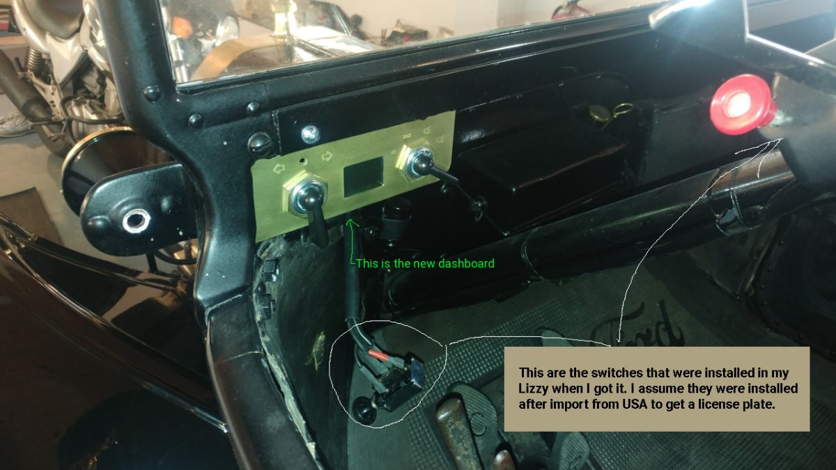

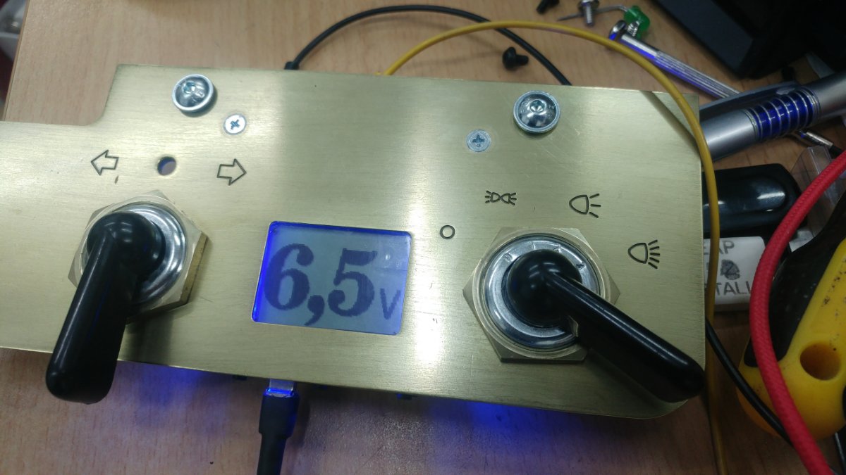

Yes, I am talking of "some sort of trigger sensor". I made the entire dashboard by myself, including two light switches and a little display, showing battery voltage and speed. I made a short video available if you want to see it.
Mounting the sensor at a front wheel is not beautiful. Simply too exposed. Also the distance between magnet and sensor varies with orientation of the wheel when steering left/right, and the cable is permanently in move. Also the EMI (electromagnetic interference) from ignition into the sensor is much higher than at rear wheel. Therefore I decided to mount it at a rear wheel, this (hopefully) will never change its orientation.
I will use a "U" clamp/mount on the radius rod, this will be the best choice. I had another look on the car right now, the rod from clamp towards the wheel spokes is approx 4" only, this is the best option. I will use stainless steel because it is non-magnetic and has no effect to my sensor, painted black to fit the car..

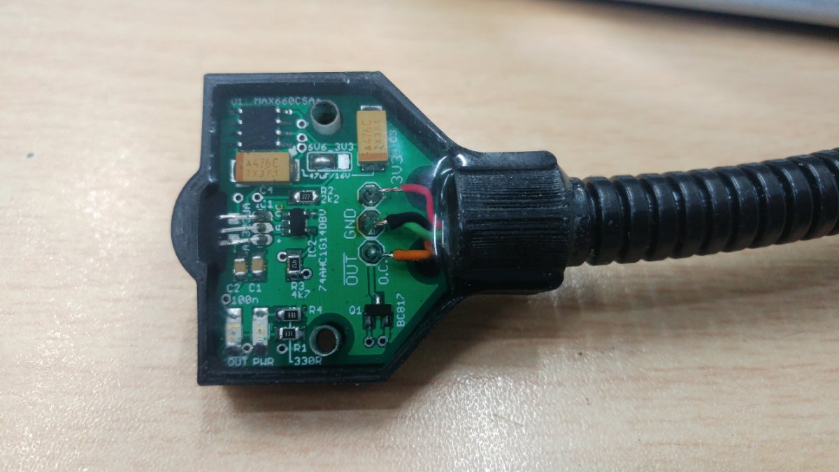

This is my self-built sensor. It has some electronics inside to make it extremely resistant against EMI.

Therefore I use in my electronics everywhere shielded cables now. ("Shielded" means that each cable and/or wire has a fine copper mesh around it (like a TV antenna cable, only lots thinner). The copper mesh is connected to chassis ground of my Lizzy.) I also use extreme filtering and protection on all connections of my dashboard electronics.
You should also try shielded cables. I am pretty sure they will help a lot. I don't know Electronics Stores in USA, but I think stores like Radio-Shack (does it still exist?) should sell you cables in any length you need. Ask for stereo-microphone-cables, if your bicycle speedometer has two wires to the sensor. This cables are of very high quality (but cheap). There are two wires inside (often red and white, but color doesn't matter), and each wire is covered by a fine copper mesh. Replace the entire cable between bicycle speedometer and its sensor by this cable. Twist the copper meshes together and connect this twist directly to chassis ground on speedometer side. The wires you connect to the sensor and speedometer, respectively. Of course, you need to use soldering iron, shrinking tubes, ..., if you don't have that equipment, you should please somebody to do this for you.

Meanwhile I had a test drive with the cable from dashboard to the left-rear wheel connected to the dashboard. This cable was therefore already exposed to this harsh environment and received it like an antenna, but there was no difference to before (without this cable connected) -- the dashboard worked without any difference. Good success so far. But then the weather became too cold for further driving.

I want to share a little update.
Today I finished the holder for my wheel sensor. It is made of stainless steel and finally painted black.
This is the rough cut&bend of the holder. It perfectly slides over the radius rod with only a very little play. The sensor mounting holes are already marked but not drilled. Long-nuts for clamping are not welded on yet.
Here the sensor is temporarily mounted. My Lizzy has AC brakes installed. This braked have a spring for opening and a lever for closing. The sensor will sit between spring and lever (there it is in a safe place and not so exposed) in a distance of 12mm (~1/2") from the wooden spokes.
Here the paintwork is drying. You can see the M5 long nuts for clamping the holder to the left-rear radius rod. The cable runs along the radius rod to below the battery, then it goes up in a bow and is fixed at the battery holder. There it has a waterproof plug to allow removal of sensor when needed. The cable is then running inside the left steel frame to my little dashboard.

As promised, I want to share a few pictures of my finished Speedometer. The wheel sensor is mounted and connected to my dashboard. It is too cold for a test drive, but I moved my Lizzy in my garage to test. It perfectly works.
The sensor has two little LEDs inside. Green is the PowerLED (permanently on when battery safety/main switch is on, red is the TriggerLED, sitting besides the green one. I love LEDs, they allow easy control if everything is working properly. If the LEDs are irritating I can use a piece of black tape to cover them. The TriggerLED goes on when the magnet stick (inside one spoke) is detected. You see absolutely nothing of this magnet stick.
This is a view from the rear to the left wheel. As you can see, the sensor vanishes between all this rods and levers. This picture was taken from below the car. Here you can see the second half of the sensor holder.

Here you see the finally mounted dashboard.
This is a picture taken at the very beginning of my restoration work, therefore the rest of my Lizzy is still very unfinished. But I think this shows better where my cables are running. The wires from dashboard run along the wooden body (inside the black protection tube) down to closely above the flange of the steering column. There they cross the firewall, and end in an old looking fuses-box with six Torpedo Fuses. From there the cable trunk goes down till 2" above the starter. There I made two additional holes through the firewall. The reason is simple - keep cables away from engine so the engine can be pulled without complications.
This pictures show the dashboard before it was finally mounted from front and back side. (The green LED above left switch is missing.)
The upper part (where you see the countersunk head bolts, including them) is hidden behind the windshield holder. Also 1/2" of left side is hidden behind the body. It is there to stabilize the dashboard. From this point of view the dashboard appears lots bigger than it actually is. It is in brass, so it matches the overall appearance very well.
Here is the oldest picture I found.
Of course, my bolt heads are painted black now. I had to drill a second hole for the right bolt, but actually it looks lots better now than ever before. This ugly chrome switch (must have been installed in USA because direction lights did not work as needed in Europe) on steering column is replaced by the left rotary switch on my dashboard (direction lights), the pull switch is replaced by the right rotary switch (Off - Position Lights - Low Beam - High Beam).
Little remark to the first picture:
On first picture you also can see my self-made "inner choke lever" right of the coil-box. I removed the original headlight switch for it, it was brutally painted over in black by the former owner and had no function at all. The choke wire was running through the same hole as the gas mixture adjustment rod, it was extremely ugly. I re-used its hole to insert the 3D-printed and brass painted panel and handle. On engine side another lever is mounted. From there a nicely bent wire goes down to the carburetor.
