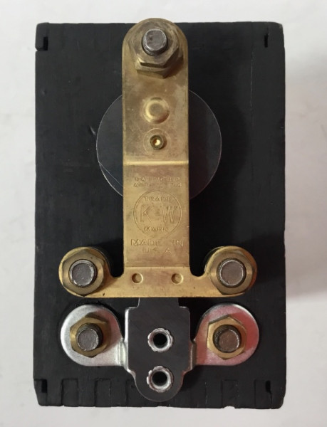

Which years does this spark coil fit?
Good evening. What years does this size spark coil fit? I know it fits the 1926 and ‘27, but I’m not sure of the other years it fits. If I’m not mistaken, the earlier years used a different size. Thank you for your help. Jim Patrick

Nice clear, vibrant close-up pictures. It’ll ‘fit’ in a 14-16 coil box but wouldn’t be correct. Otherwise, it’ll fit and be correct for all 17-27 Model T s.

The specific coil depicted in your photos is typical of the "standard" size (non metal top) coil adopted for the Model T mid year 1917 and can be used in the metal coilbox that was introduced in mid year 1913 and used till thge end of Model T production.
The "standard" size all wood and metal top coil are interchangeable in any metal coilbox with the exception that metal top coils (1913 to mid year 1917) should not be used in the 1926-27 metal coilbox. The the coilbox lid spring tabs that securely hold the coils in place inside the coilbox will interfere with the raised metal stamping. The tabs will distort and can short the coil points to ground.
A few comments about the specific coil pictured above. After the Wheat gluten cast design was withdrawn and the standard all wood was adopted there was a short time when coils made by Ford had no Ford script. The branded Ford script showing first appeared in 1919 (I have forgotten the exact date) and was changed to the rolled in script on the top edge of the wood case top in February 1923 and remained unchaged till the end of Model T production.

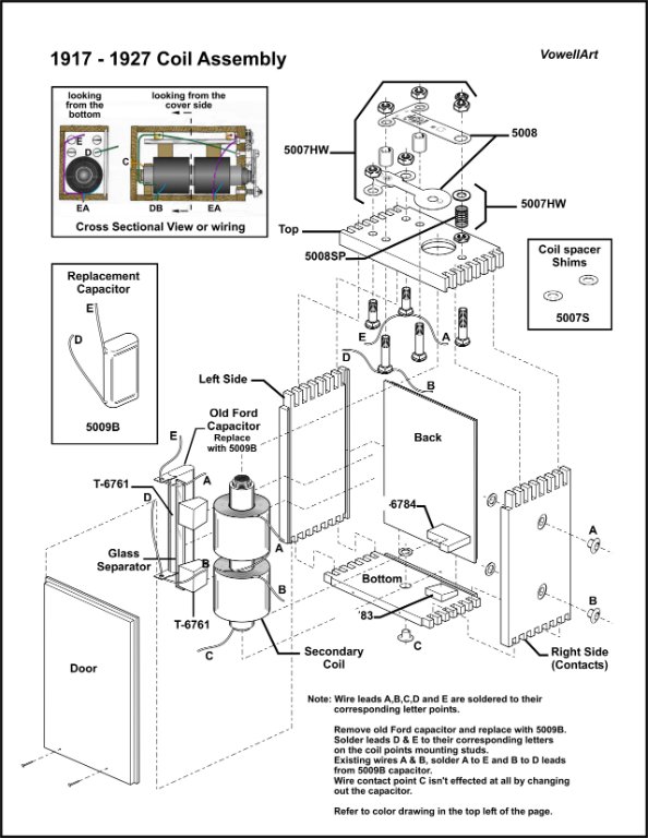

Martynn,
Great drawing! I think it is the first time I noticed it.

Um Matt, all my drawings are here on the Forum under MTFCA.com/Resources/Drawings or from the forum page in Gallery/VowellArt and are free to all members to use or download. So, if you need to look for something for your car, there's a good chance you'll find it there...but I've still got a few other assemblies to go before I can finally get to that damned big, heavy, noisy, thing up front, which will complete the chassis.
