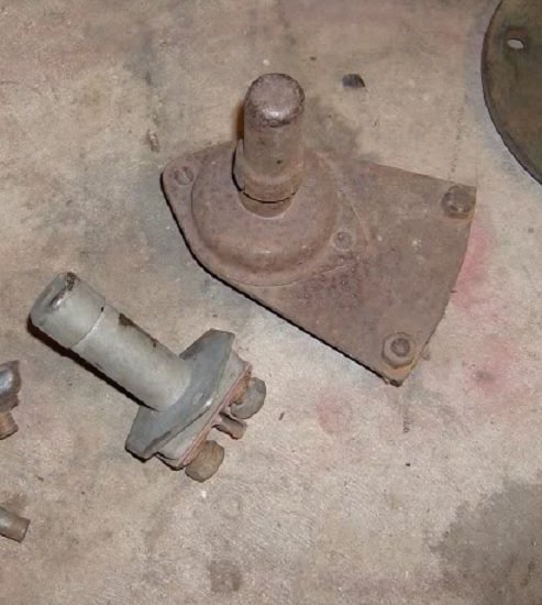

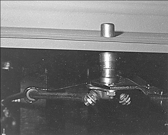

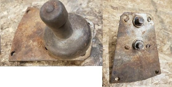

To properly provide an answer to you problem it would help to eliminate solution assumptions. The reason is that many Model T's have owner modifications; changing to a 12 volt battery but nothing else; buying an after market starter switch; cranking duration over 10 seconds etc..
Also a picture of the "starter switch" would help there are several styles but doubt that's the issue. The internals can be seen in this link http://www.mtfca.com/discus/messages/59 ... 1475270003
If it were me I would focus on the starter

Your Model T starter is arranged very much like the Model A system, except the starter switch is not mounted on the starter. Your T should have heavy cables of good quality, same as the Model A, a good quality battery, and all connections must be clean and tight. If you have a battery disconnect, it could have problems, as could any connection in the system, including the engine grounding to the frame. If your problem was isolated to one point, such as a battery connection or the starter switch, I would expect that particular item to heat up. If everything heats up, assuming you're not grinding on the starter for extended periods of time, that suggests a starter issue.
