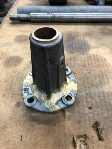

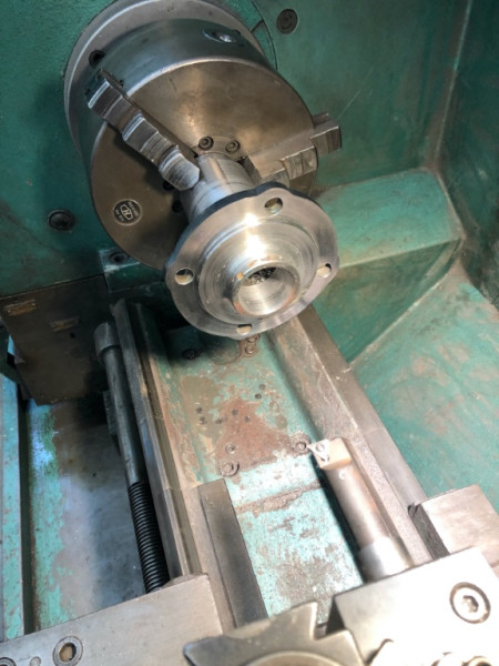

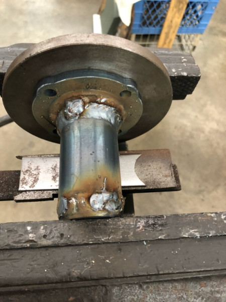

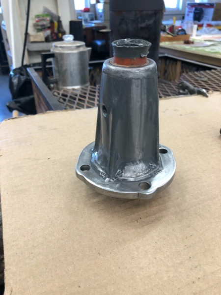

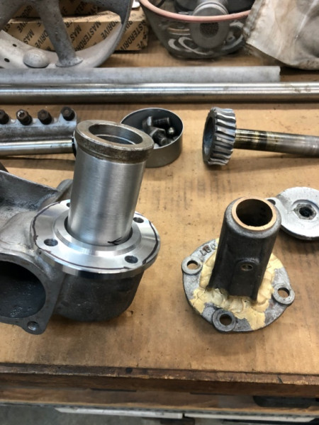

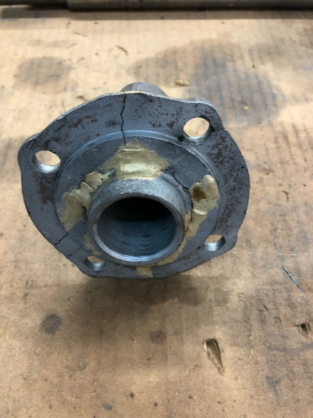

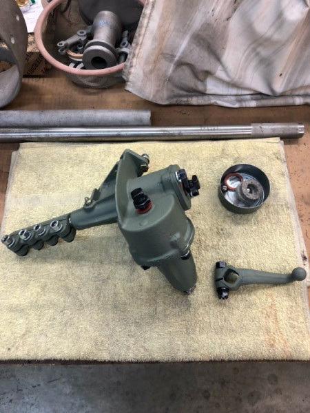

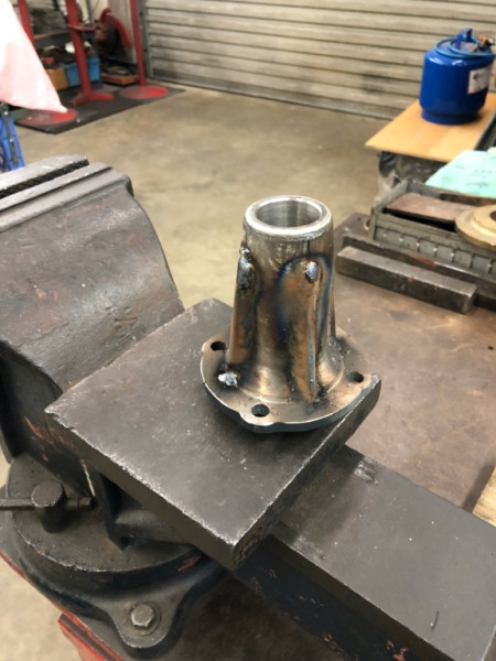

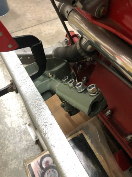

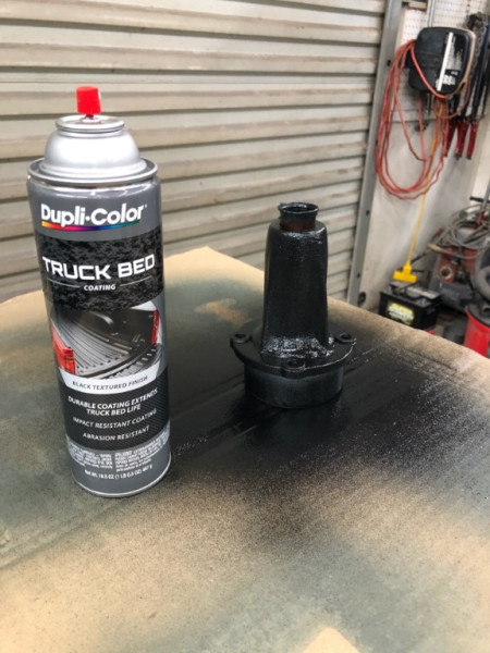

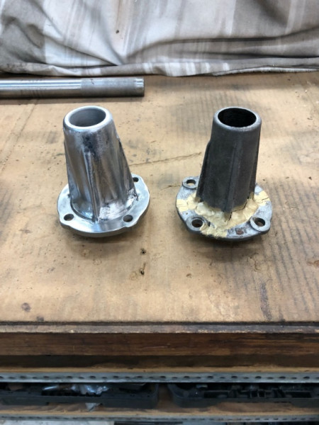

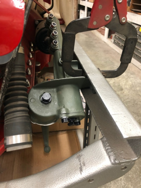

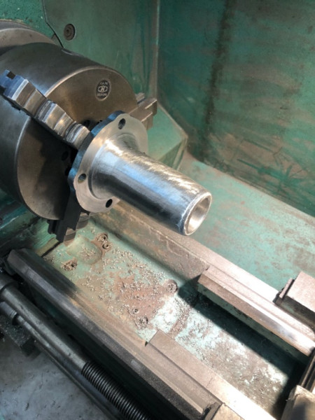

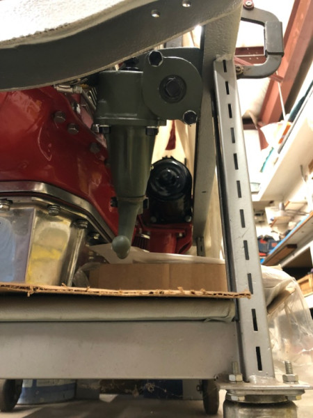

You start from ground zero. Been here before, same situation years back when a friend with an early model Caterpillar Road Grader had a case break. They were notorious for the exact same thing.., poor design in the support web on the pitman arm shaft case. Caterpillar wanted...., $14,000.00 for a new replacement steering box and a wreaking yard in Arizona wanted...., $4,000.00. Yes..., those figures are correct!
So this is off of some car of the era 1920's? But perfect for my 1927 RPU on steroids!
I purchased this from another club member as after he received it and blasted the crud off, he noticed the repair and breaks. Disappointed in his decision of the buy, we agreed on a price. This size box will fit into the channel of a Model T frame with some machining which I wanted this style being 7 to 1 ratio for my last T project.
So here are the results that if you think it out, not all is lost. Made from shop scrap steel, false webs, and textured to look like cast iron. The internals are in beautiful condition! Enjoy my long weekend therapy!

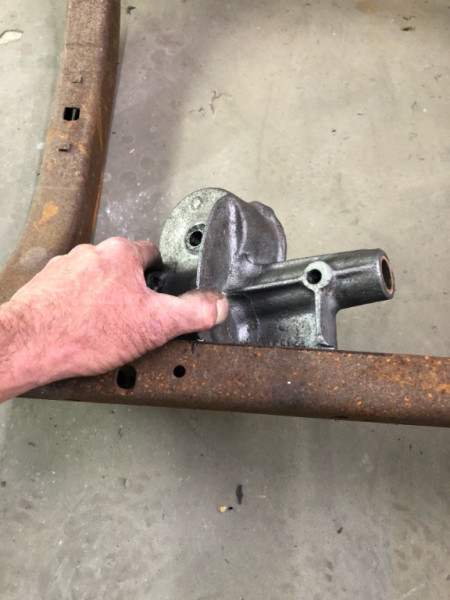

Eric, It was a great strong design except for that output shaft housing. Would like to find out the car it came from as with little machining has great clearances in a T frame rail. Will still need to put an upper and lower anti frame twisting bracket like with a Vega box, since torque is now at the frame and not being transferred thru the steering column tube.

Post by Henry K. Lee » Sun Nov 28, 2021 5:57 pm
Nice Clearance!!!!!
