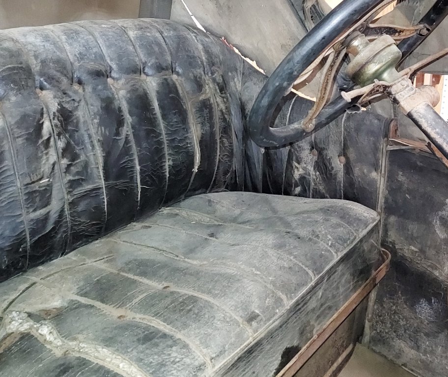

Brian, I have done a classic car, closed model T and open model T, and open T is by far the most difficult. On your scale of 1-10, I give it a 10. The wrap around seat back is what makes it so difficult. Getting the buttons the right height and the upholstery to smoothy wrap around to the side and arm rests is a process requiring removing and trying again repeatedly. Do not drive your tacks home until you have everything where you want it. If you do it right you should not be able to tell where the seat back rest springs end and the sides begin. Upholstery and top on an open car is 50 % of the cars appearance, dont go cheap or get some local guy to try his hand at model t upholstery for the first time. Upholstery and top is worth a quality job. If you want to do it yourself get the best quality kit money can buy...or pay the kit maker to install it. The picture is my unrestored 1924 runabout, not the same as a 15, but the seat back is similar.
