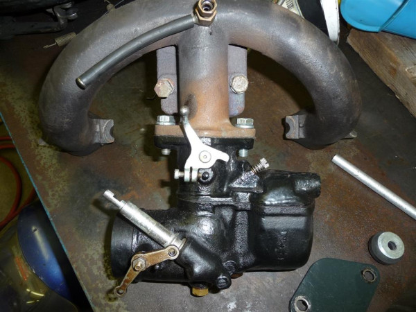

This is the set up for carb and intake I was considering. Reading a little bit the T and A are interchangeable??.
Carburetor/manifolds
Topic author - Posts: 1152
- First Name: Bryant
- Last Name: Shafer
So Iam wondering if anyone that has tried a model A carb and manifold set up? I was thinking about this option and wanted to see if there was any draw backs to it. Iam not worried about being a purist so I’d appreciate positive feedback

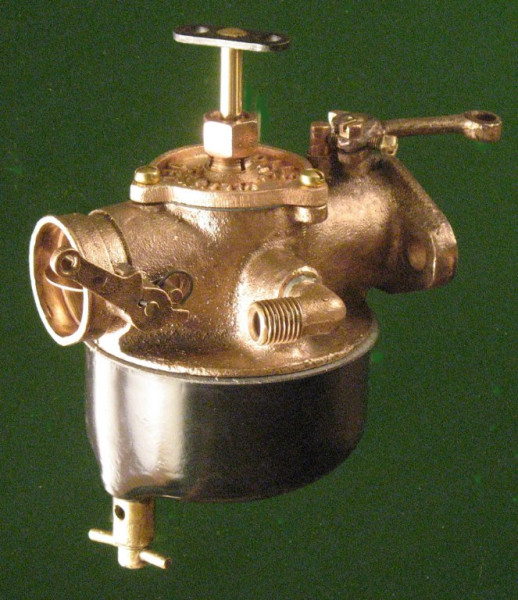

I really like the brass stromberg carbs. I was attracted to the zenith because of all the classic tractors I’ve played with. Kinda reminds me of there set up. I guess the rest is price/availability.Scott_Conger wrote: ↑Wed Nov 24, 2021 2:59 pmThere are plenty of period/accessory carbs which will make a stock T run MUCH better than the standard carbs which came with the car.

I like the period looking ones. The brass is great! I like the model A one. to me it looks fine. Just a little plain and simple. Seems very available. But when the hoods down it’s the model T I like. If you have any pictures of these carbs I would love to see them.
I think these clean up real pretty.

Bryant, many have done this conversion, the best setup I have seen was the B intake and exhaust manifold, the intake is larger for more air flow and the exhaust manifold kicks it out behind the engine like a T does. I would not go through all this unless you have went to larger valves, cam, head or hi comp pistons, the engine will run but to get the flow out you need these upgrades. Hope this helps?
- Last Name: Shafer
Re: Carburetor/manifolds
Thanks! I have been looking at manifolds but am still not sure of the abc differences. what is what? The engine is fresh. Has the adjustable 350 Chevy valves. Will be getting the z-head. And now pondering a cam. With all that said I would also like to try a stomberg. Are we having fun yet? Iam at the beginnings of this journey and don’t mind trail and error situationsJoe Bell wrote: ↑Thu Nov 25, 2021 10:00 amBryant, many have done this conversion, the best setup I have seen was the B intake and exhaust manifold, the intake is larger for more air flow and the exhaust manifold kicks it out behind the engine like a T does. I would not go through all this unless you have went to larger valves, cam, head or hi comp pistons, the engine will run but to get the flow out you need these upgrades. Hope this helps?

Bryant : The carb/manifold pictured in your original post is a B set-up, not Model A. One of the biggest mistake guys make in looking for a performance improvement is to over-carburate, (an old mechanic buddy of mine used to say "it's like puttin' a 650 CFM Holley on a lawnmower and expecting it to run perfect"). Those that have mentioned bigger valves and cam profiles are on the right track for a modification like this to a T motor, but don't forget that paper-clip crankshaft. As well, you mentioned a Z head but you might want to look close and compare a Prus head, in combustion chamber shape, head gasket surface area as well as machining tolerances. Good luck: Bruce
- Posts: 4726
Agreed. Prus head. I didnt catch the B carb. An A works well.Bruce Compton wrote: ↑Thu Nov 25, 2021 8:46 pmBryant : The carb/manifold pictured in your original post is a B set-up, not Model A. One of the biggest mistake guys make in looking for a performance improvement is to over-carburate, (an old mechanic buddy of mine used to say "it's like puttin' a 650 CFM Holley on a lawnmower and expecting it to run perfect"). Those that have mentioned bigger valves and cam profiles are on the right track for a modification like this to a T motor, but don't forget that paper-clip crankshaft. As well, you mentioned a Z head but you might want to look close and compare a Prus head, in combustion chamber shape, head gasket surface area as well as machining tolerances. Good luck: Bruce
A B/C carb. May be too much. Like I said. An A works on a T & a B/C works well on an A.
You might gain top speed but low end performance may suffer. That would be the over carburation Bruce is warning you of.

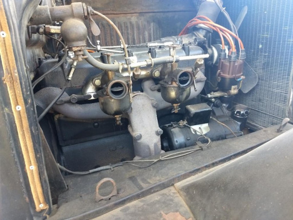

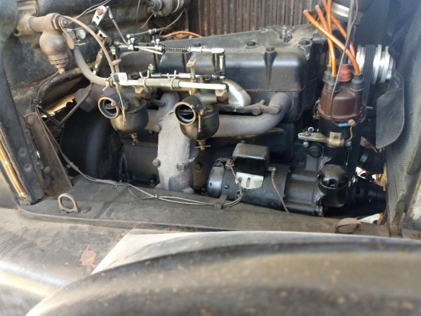

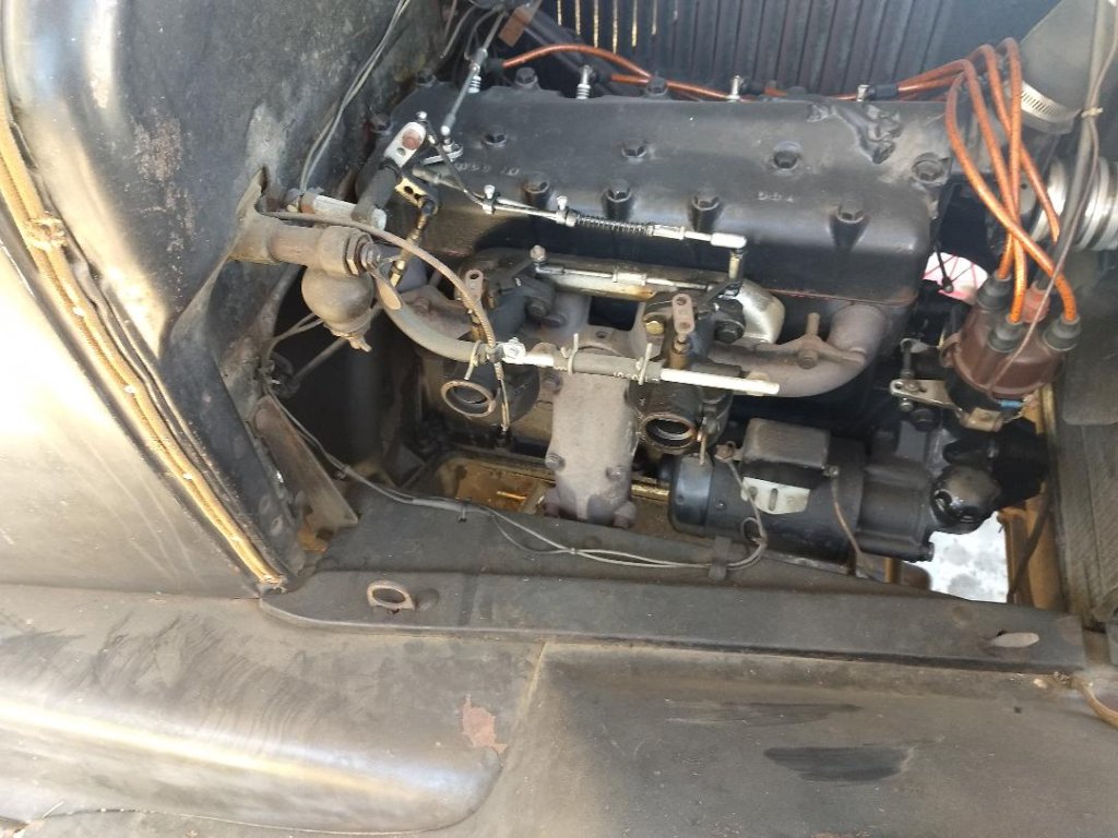

Bryant. Dont be so quick to dismiss stock model T carburation. A good holly NH (or 2) can provide plenty of fuel to the "package".
I developed this configuration in my post model A carb experimentation period.
Why hasnt any body.....I wonder if........... It met certain criteria, like period & no fuel pump, simple & cheap to build. IMO, neat looking.
The "package' consists of an iron lizard hi compression head. Capped vaporizer manifold center exhaust out A 2" pipe to a wheeler type can. Intake is built from 2 stock manifolds. 1.5" exhaust & 1.75" intake valves. Scat crank. Stipe 280 cam? 2 NH's with exact fuel levels & synchronized. Hand throttle with an over riding foot throttle to shift the rux. 8V battery.
I wanted speedster performance from a fully loaded roadster P/U. She serves me well.
An important thing I learned on the first test drive was the front end needs to be "tight & right" to enjoy/control the extra horses.

That’s pretty slick! Love it! Iam a fool for linkagesspeedytinc wrote: ↑Sat Nov 27, 2021 9:48 amBryant. Dont be so quick to dismiss stock model T carburation. A good holly NH (or 2) can provide plenty of fuel to the "package".

speedytinc I love that manifold & carb setup. I have tried many setups on my speedster. I find a adjustable large carb to be very good if mated with a good exhaust. But takes some tinkering while driving. My number one concern is getting equal flow to #2 & 3 as 1 & 4.Thus making two cylinders run richer than the other two. This seems to limit performance gains as the manifold flow is one direction then the other. Most all four cylinder engines are now firing 1-3-4-2 or 1-4-3-2 to even out the manifold flow and balance the air fuel charge in the cylinders. ( this is one of the reasons Ed Windfields 2 up 2 down engine ran so well ) Short of making a cam to change this or reversing the flow ( 4 INTAKES & 2 EXHAUST ) Has anyone tried making a manifold to improve this issue? Large plenum or directed flow.? Will 2 carbs help with this? ( it still seems you will get a on off flow) Just some random thoughts.
Craig.
Craig.
- Posts: 4726
Tinkering while driving.
O yea. I have 2 3' rods to tune the 2 carbs while testing different speeds/conditions. The 2 carbs are manifold equalized. I suspect 1 & 2 or 3 & 4 can be richened/leaned for some effect. Plugs show same burn on all cylinders.

No. 2 stock manifolds cut up. The updraft, curved leg portion cut off & the edge (1/2 round) used as a filler on top as pictured. All brazed together.Bryant wrote: ↑Mon Dec 06, 2021 9:27 amDo you have any pictures of your intake build?speedytinc wrote: ↑Mon Nov 29, 2021 11:00 pmTinkering while driving.O yea. I have 2 3' rods to tune the 2 carbs while testing different speeds/conditions. The 2 carbs are manifold equalized. I suspect 1 & 2 or 3 & 4 can be richened/leaned for some effect. Plugs show same burn on all cylinders.
