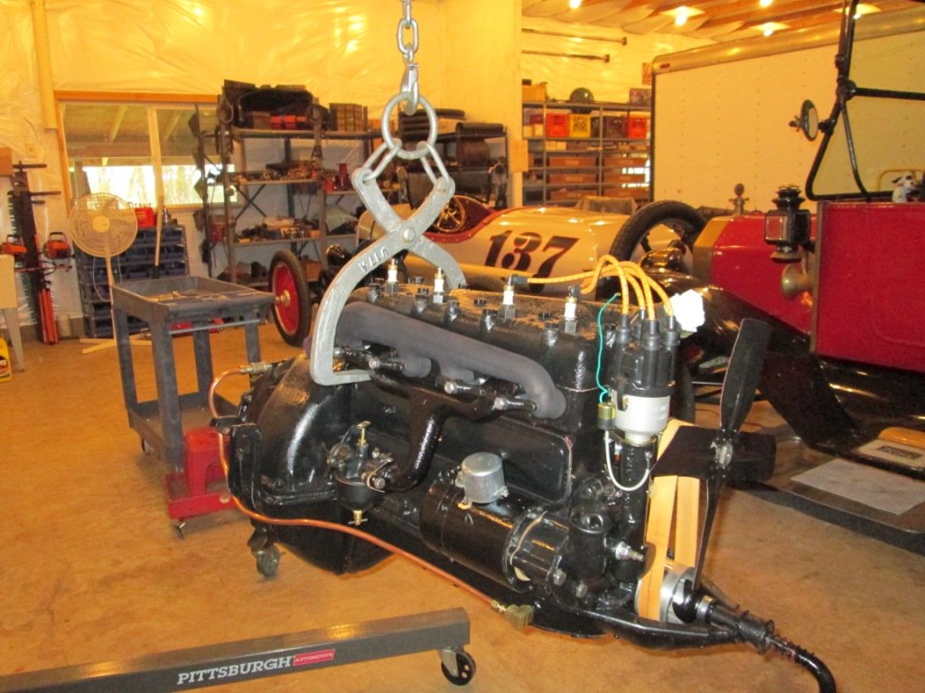

Joe - not sure how the factory did it, but I recently rewired my ‘26 RPU - every cable and wire including light sockets and thimbles. Pretty straight forward job - chassis wires to terminal block; wired ignition/light switch loom through the dash and firewall hole to terminal block.
I don’t know if the Tudor is more complicated than the Roadster, but I’m sure you will get plenty of support on the forum.

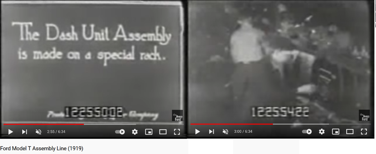

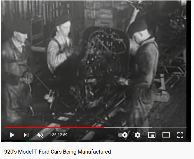

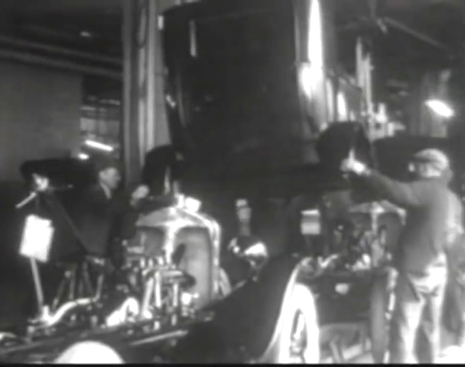

This is a clip from a YouTube video
I don't think it matters if its wood or steel in this photo because the assembly process wouldn't change for this shape firewall
Ford Model T Assembly Line (1919) https://www.youtube.com/watch?v=Pf8d4NE8XPw --
This video show placement before the body is put on
1920's Model T Ford Cars Being Manufactured https://www.youtube.com/watch?v=4e3orWGmQ-o

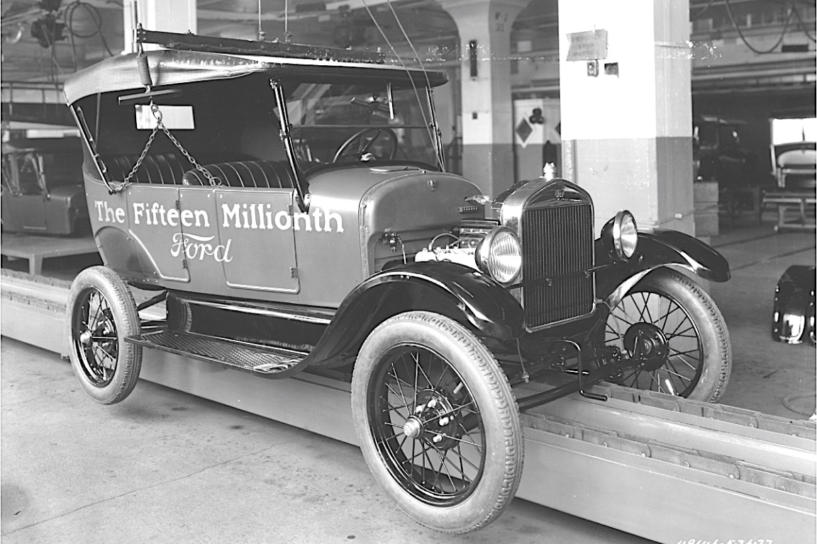

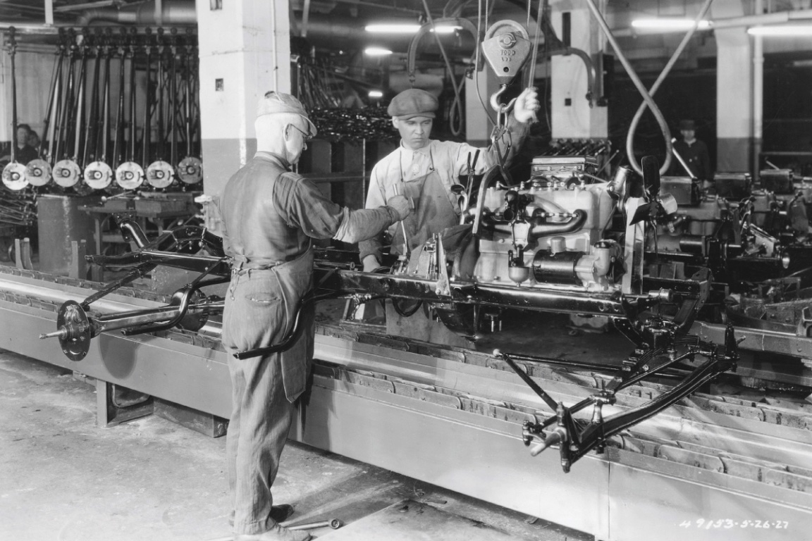

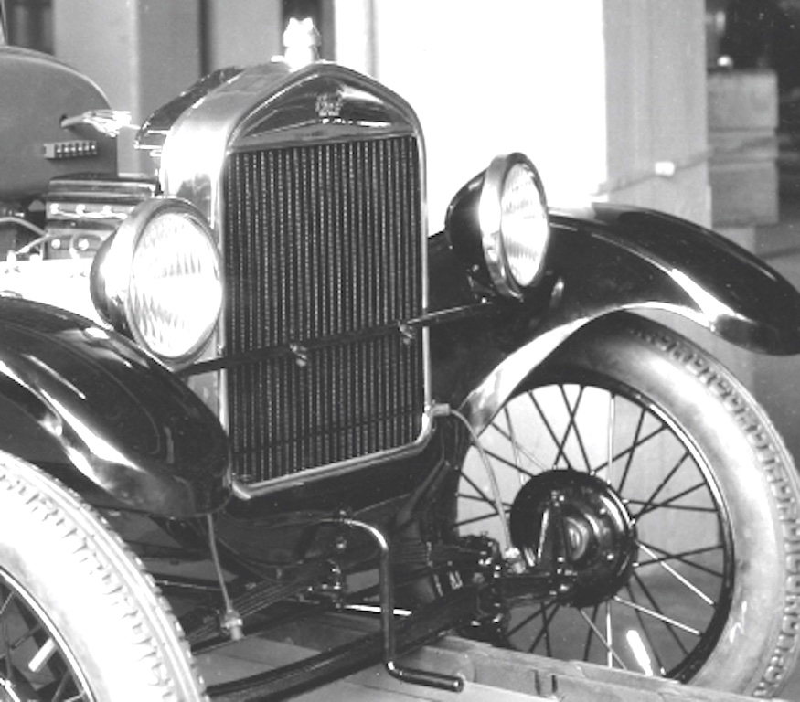

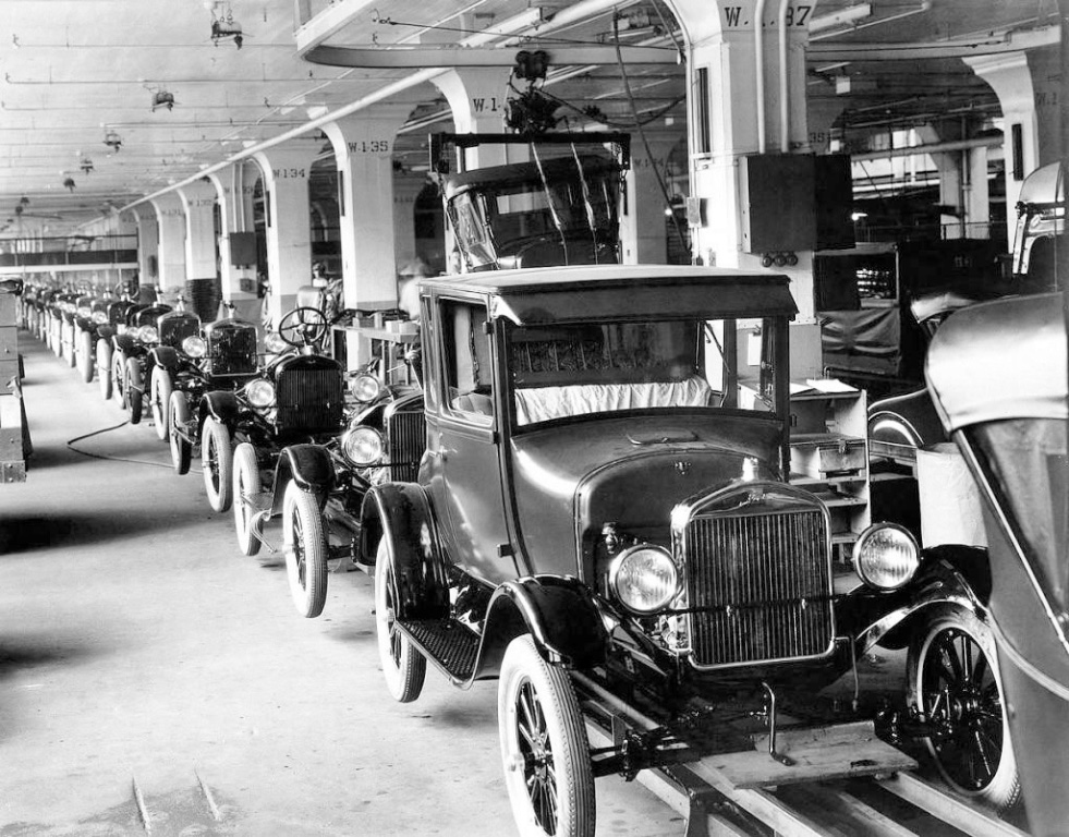

The Improved Car '26-'27 came along with improvements to assembly line too.
As for your wiring questions, the chassis was wired at ignition, and lighting looms as it chain drove down the line, note the 15th Million, coil box on engine, wires to plugs and timer already on the engine during engine drop.
The body was fitted with the switch wire loom before the body drop, as dash and switch plate were in prior.
Note the switch loom sticking out the firewall as the lighting loom headlamp wires dangle below the lamps
Lastly would be the tail lamp wire to the rear fender. Battery and starter foot switch loom would have been installed on the chassis.
Closed cars would be done the same.
