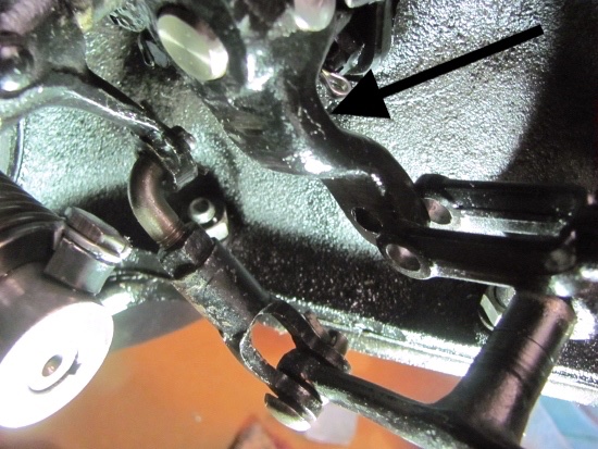

Might inspect for interference somewhere. Floorboards or the linkage of low pedal to the clutch lever.
The linkage sets close to the repro Rocky Mt. brake pedal, have had to grind off thickness of some of that large cast pedal extension to be sure of clearance of the clevis or the linkage shaft end for the cotter to be sure the brake pedal didn't interfere with the clutch/low pedal.
