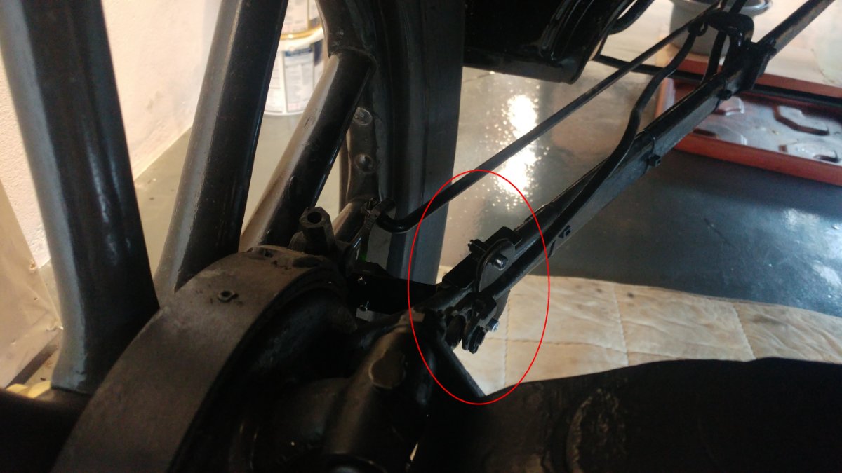

My car is a '16 Touring with wooden spokes and additional AC brakes (they work on outside of emergency rake drum, that ones).
This weekend I want to start building a holder for the Speed Measurement Hall Sensor. This sensor I want to mount at left-rear wheel, closely to the AC brake, in approx. 1" distance from the wooden spokes. To make it mostly invisible, it shall be located closely to the outer dimension of AC brakes and somewhere in lower region (between 4:00 and 8:00 position), so the brake is hiding it.
Idea 1:
It would be best when I could loosen one or both nuts from the diagonal stabilizing bar, coming from U-Joint and ending with its fork at the brake drum (no idea how it is named). Then I can put a piece of cut sheet metal over the threads and re-tighten the nuts. This sheet metal is the base for a piece of steel rod then. But I am scared that I will have to take off the wheel (and possibly even more) when the bolt needs to be held for tightening the outside nuts. Currently I do not have the tools needed to pull the wheel.
How is the situation here? Can I take off at least one nut, and tighten it again without access to the bolt head (if there is one inside)?

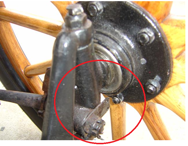

I think you are referring to the outer/rear end of the radius rods that stabilize the rear axle housings relative to the torque tube which houses the drive shaft?
Generally, attempting to loosen either of the two bolts at the back end of the radius rod without first removing the wheel is a very bad idea. The bolt head inside has nothing to hold it in place, and most likely will spin in its hole not allowing removal of said bolt or nut. Gripping onto the exposed threads will likely bugger them up badly, and simply make the entire situation worse. You might be able to get it apart? But if you bugger up the threads of the bolt? Getting the nut back on is going to be far worse than getting it off was! Getting it tight enough to not rattle and wear out will become nearly impossible.
Sometimes? Sometimes the wheel will come off easily with simple common tools and surprise you. Maybe give it a try? Maybe you can get ahold of the hubcap and remove it without damage? (I have done it a few times without the right wrench?) If the hubcap comes off, then it is a cotter pin and a common hex head castle nut which common tools work on. IF, BIG IF! IF the wheel might be a bit loose on the axle taper? SOMETIMES the wheel will come off easily. IF it does? Its a good thing to discover and fix now at your convenience. The wheel should not be that loose.

If I remember correctly, this car is new to you. You really should remove the rear wheels and check your bearings, sleeves, and seals before you drive the car any long distance. You only need the puller and a new cap at this point. I suggest you get the newer cap.
IN the meantime you can design Idea 1 which is probably the best of your three designs.
Remove your wheels and examine them. Make sure the bolts on the wheels are peened. Regrease and install your bearings(usually do this every year if you drive a lot). Now you can easily install the bracket for your Speed Sensor. Put the wheel back on. Now you know that everything is correct and you will feel safer driving your car.

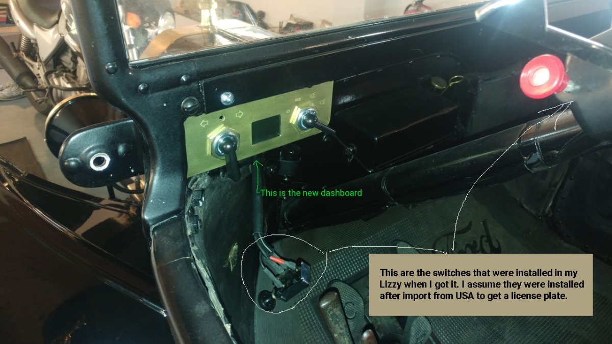

Thank you so much for your answer.
Yes, I mean the outer end of rear axle, where the Radius Rod (I found out its name :lol: ) is bolted on. This is exactly what I was afraid of, that the bolt head is not held in a hexagon hole against turning. I will stay far away from loosening this bolts then.

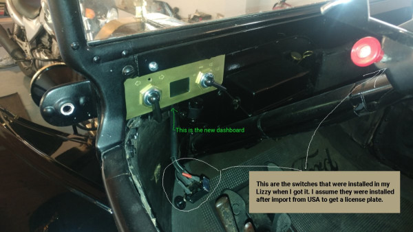

Yes, I am talking of "some sort of trigger sensor". I made the entire dashboard by myself, including two light switches and a little display, showing battery voltage and speed. I made a short video available if you want to see it.
Mounting the sensor at a front wheel is not beautiful. Simply too exposed. Also the distance between magnet and sensor varies with orientation of the wheel when steering left/right, and the cable is permanently in move. Also the EMI (electromagnetic interference) from ignition into the sensor is much higher than at rear wheel. Therefore I decided to mount it at a rear wheel, this (hopefully) will never change its orientation. :lol: Also, the sensor will almost vanish between all the other parts of AC brakes.
I will use a "U" clamp/mount on the radius rod, this will be the best choice. I had another look on the car right now, the rod from clamp towards the wheel spokes is approx 4" only, this is the best option. I will use stainless steel because it is non-magnetic and has no effect to my sensor, painted black to fit the car..

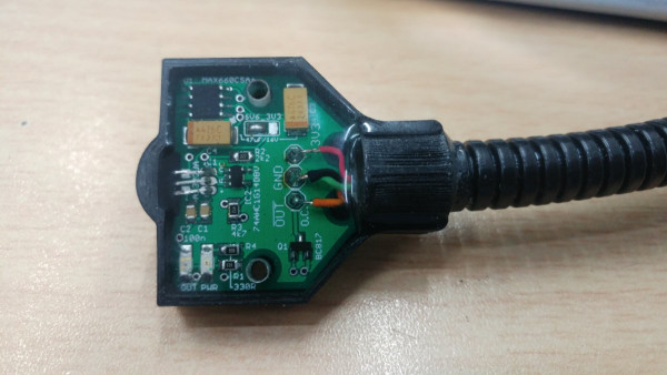

This is my self-built sensor. It has some electronics inside to make it extremely resistant against EMI.

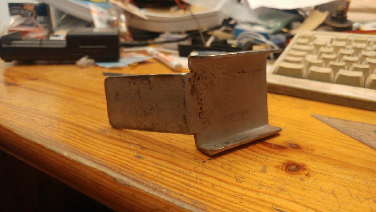

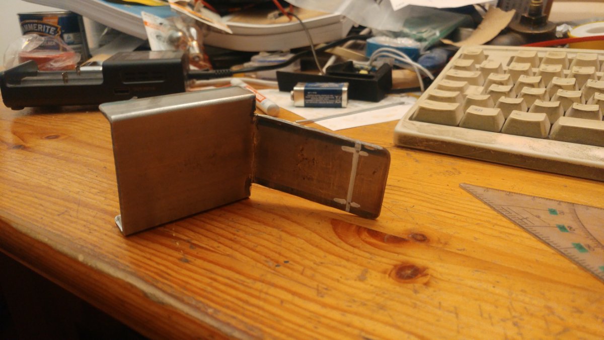

Today I finished the holder for my wheel sensor. It is made of stainless steel and finally painted black.
This is the rough cut&bend of the holder. It perfectly slides over the radius rod with only a very little play. The sensor mounting holes are already marked but not drilled. Long-nuts for clamping are not welded on yet.
Holder cut&bent from 50x30x2 mm rectangular pipe
Viewed from other side

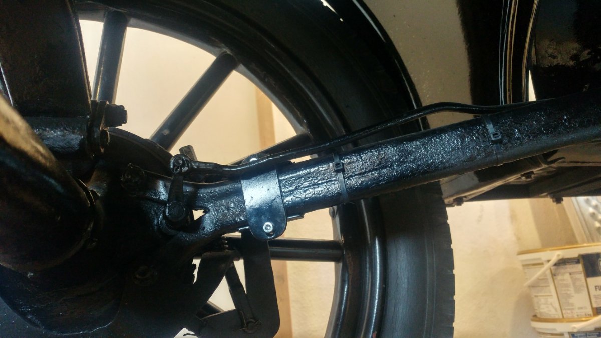

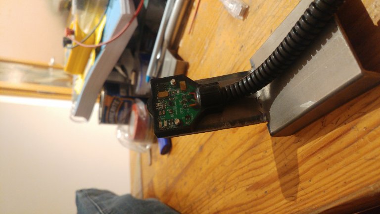

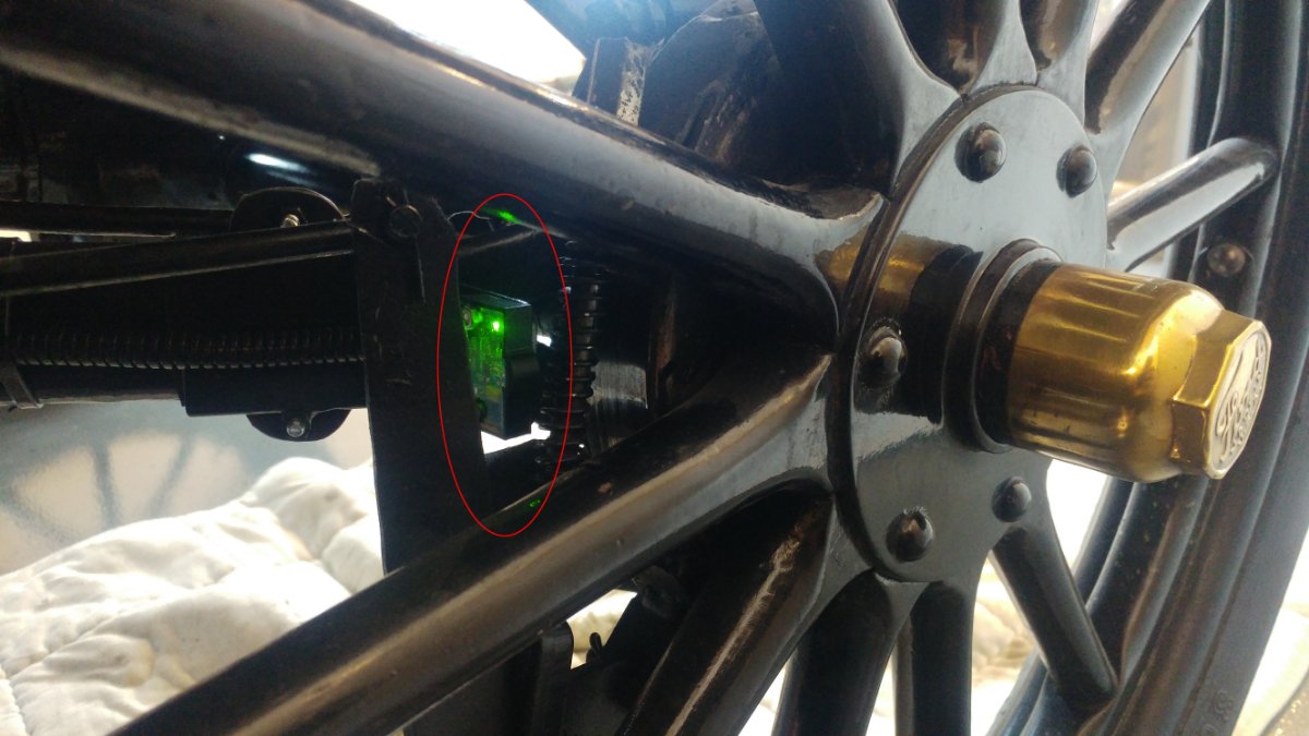

Here the sensor is temporarily mounted. My Lizzy has AC brakes installed. This braked have a spring for opening and a lever for closing. The sensor will sit between spring and lever (there it is in a safe place and not so exposed) in a distance of 12mm (~1/2") from the wooden spokes.
With temporarily mounted sensor

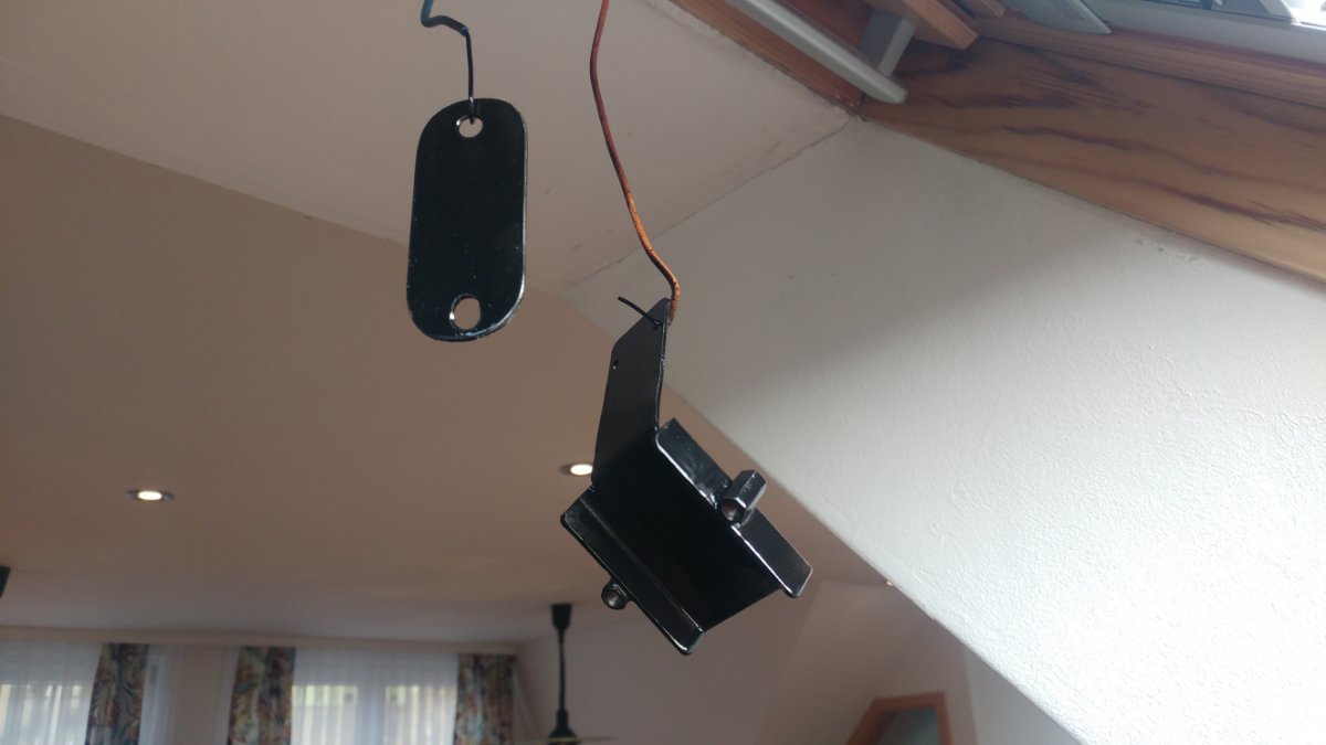

Here the paintwork is drying. You can see the M5 long nuts for clamping the holder to the left-rear radius rod. The cable runs along the radius rod to below the battery, then it goes up in a bow and is fixed at the battery holder. There it has a waterproof plug to allow removal of sensor when needed. The cable is then running inside the left steel frame to my little dashboard.
Painted black
Painted black

As promised, I want to share a few pictures of my finished Speedometer. The wheel sensor is mounted and connected to my dashboard. It is too cold for a test drive, but I moved my Lizzy in my garage to test. It perfectly works.
The sensor has two little LEDs inside. Green is the PowerLED (permanently on when battery safety/main switch is on, red is the TriggerLED, sitting besides the green one. I love LEDs, they allow easy control if everything is working properly. If the LEDs are irritating I can use a piece of black tape to cover them. The TriggerLED goes on when the magnet stick (inside one spoke) is detected. You see absolutely nothing of this magnet stick.
Left rear wheel from outside
This is a view from the rear to the left wheel. As you can see, the sensor vanishes between all this rods and levers.
Left rear wheel from inner side
This picture was taken from below the car. Here you can see the second half of the sensor holder.
Left Radius Rod where the sensor is mounted

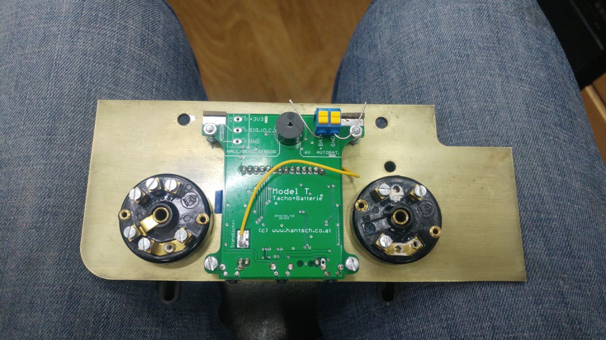

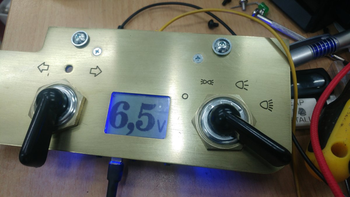

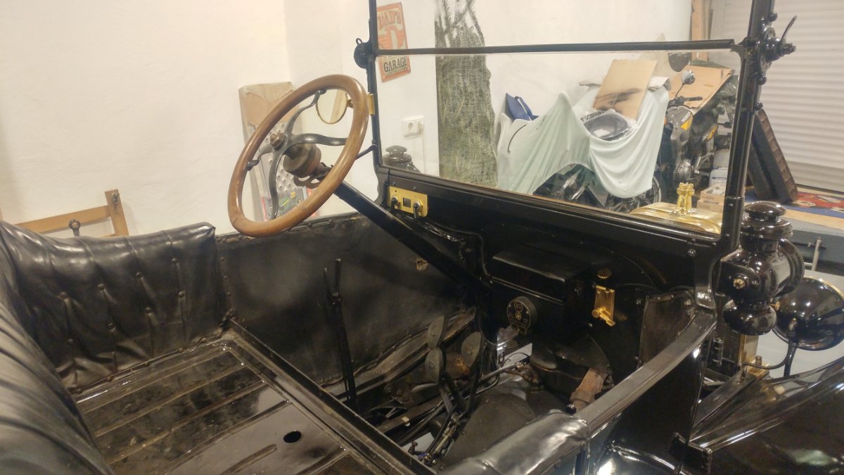

Of course, I can show pictures of my dashboard, but I only have a few ones at hands. I primarily took this pictures to have them at hands in my office (so I could look for some details there, because the car is 50km away). But you can see how it looks like.
Here you see the finally mounted dashboard.
This is a picture taken at the very beginning of my restoration work, therefore the rest of my Lizzy is still very unfinished. But I think this shows better where my cables are running. The wires from dashboard run along the wooden body (inside the black protection tube) down to closely above the flange of the steering column. There they cross the firewall, and end in an old looking fuses-box with six Torpedo Fuses. From there the cable trunk goes down till 2" above the starter. There I made two additional holes through the firewall. The reason is simple - keep cables away from engine so the engine can be pulled without complications.
Finished install of dashboard.
This pictures show the dashboard before it was finally mounted from front and back side. (The green LED above left switch is missing.)
The upper part (where you see the countersunk head bolts, including them) is hidden behind the windshield holder. Also 1/2" of left side is hidden behind the body. It is there to stabilize the dashboard. From this point of view the dashboard appears lots bigger than it actually is. It is in brass, so it matches the overall appearance very well.
The dashboard laying on my working desk
Dashboard from back side (without wiring)
Here is the oldest picture I found.
Of course, my bolt heads are painted black now. I had to drill a second hole for the right bolt, but actually it looks lots better now than ever before. This ugly chrome switch (must have been installed in USA because direction lights did not work as needed in Europe) on steering column is replaced by the left rotary switch on my dashboard (direction lights), the pull switch is replaced by the right rotary switch (Off - Position Lights - Low Beam - High Beam).
New dashboard mounted besides of old switches from former owner(s)
Little remark to the first picture:
On first picture you also can see my self-made "inner choke lever" right of the coil-box. I removed the original headlight switch for it, it was brutally painted over in black by the former owner and had no function at all. The choke wire was running through the same hole as the gas mixture adjustment rod, it was extremely ugly. I re-used its hole to insert the 3D-printed and brass painted panel and handle. On engine side another lever is mounted. From there a nicely bent wire goes down to the carburetor.
