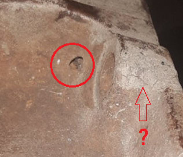

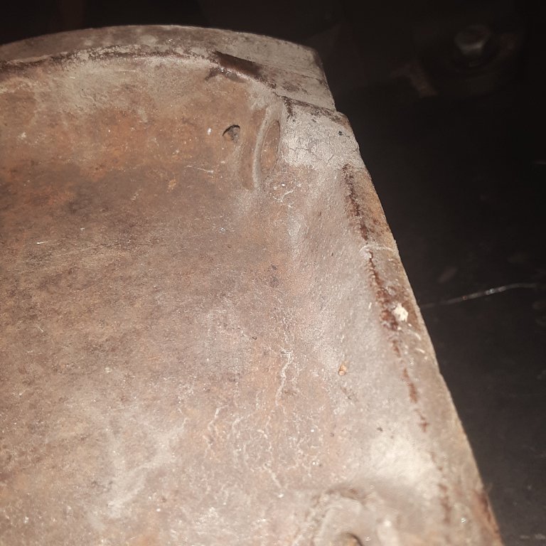

Post by got10carz » Wed Dec 08, 2021 1:23 pm
Here's a picture of what I'm talking about. This block is on my bench, the hole is about 1/8".

Post by RajoRacer » Wed Dec 08, 2021 8:19 pm
That small hole is from the magneto field coil mounting bolt hole from the back side - quite common - better check the other side also - they can weep copious amounts of oil ! The crack is in one of the block rail bolt holes.
