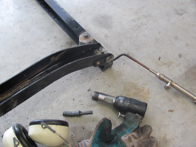

But..... a repair is done better removing the splash shields, (body lift some is needed) to get real access to the part. Then drill into the rivet heads part way, then punch out, takes some work to get off the old part. After that, air hammer and torch to heat the new rivets red and set them, two persons are best, one to rivet and one to buck the rivet head.
Just did this quadrant over Thanksgiving on the '13 frame with helpers, grandson and a son-in-law.....good workers too, did the forged running board brackets first and then the quadrant rivets , purty good for beginners! (RV Anderson supplied the correct rivets, his fasteners are made to factory prints)
Posts: 7411
Re: Replacing brake quadrant on '23 Touring...
Post by Steve Jelf » Tue Dec 07, 2021 11:25 pm
I agree on having a helper for riveting. In my case I have the helper hold the torch to keep the rivet soft until I mash it. Without a third helper I have the back-up clamped against the other end of the rivet.
