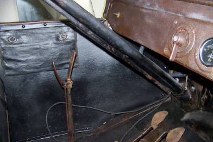

These old ones from a 1924 or so might give some idea.
http://www.mtfca.com/discus/messages/50 ... 1433642698
- Posts: 4098
Re: Door kick panels
The 'Barn fresh' '23 pickup, bought std. door cardboard, in black finish, from on-line auto upholstery source. Board came in std flat size perhaps 30" square or so?
The panel board was pebble like grain, the Ford panels were also pebble grain, but don't think you can get that same pattern today.
So to 'age' the new board, spray painted spots in flat or semi gloss rattle can, and rubbed with steel wool to depress the new shiny board, came out looking like it had been there for a long time
