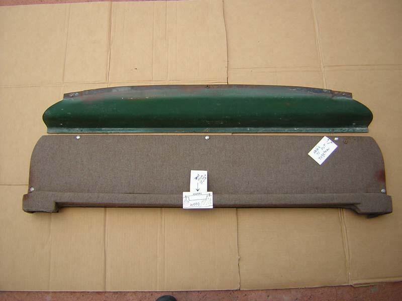

The wood needs to be strong, stable and straight. I would go with a piece of 1”x (3/4” thick) poplar, that can be purchased at Lowe’s or Home Depot. Poplar is a good, dense grained hardwood. I have a 1926 coupe but the seat shelf is upholstered and it is hard to see the construction. I found some pictures online by searching, 1926 Model T Coupe seat shelf, MTFCA”, which also brought up a very helpful 2014 MTFCA thread. The shelf goes all the way across and connects to a curved piece of steel which is upholstered over like the wood shelf. There is also a groove on the center front of the shelf that is reinforced by piece of steel that the back of the seat hangs from. Jim Patrick

PS. The upholstery is wrapped around the wood, pulled tight and stapled to the backside of the wood? It can be stretched over the metal piece and secured to the back with Gorilla tape or contact cement.

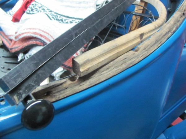

Original wood tack strips on the '26-'27 were steam bent wood, 3- 4 pieces. These had a routed step in the outer edge, to allow the backrest upholstery to lay below the top cover, so the trim looked neat.
Have used kit wood and it does need a lot of work to fit right. Oak is strong but hard to shape, needing to cut on radius to make the curved pieces.
Pictures is a '24-'25 strip, original below and repro by J P Anderson on top, he makes these steam bent. Plastic is shown to the top left.
For my use the plastic trim is easy to shape with a hot air gun, and holds tacks very well, easy to drill holes to mount to the metal. In this install used cut-down kit wood on the sides, as the bends didn't fit well to my body, and then used plastic for the longer back piece. Prefer the plastic.

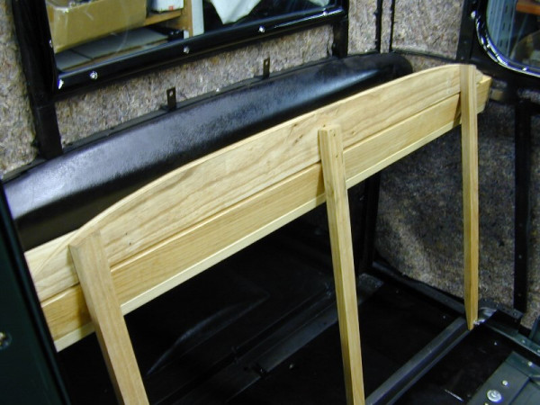

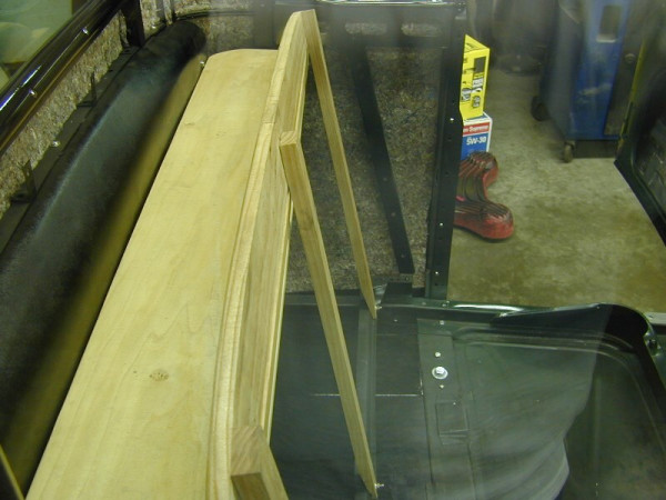

Post by Norman Kling » Thu Dec 09, 2021 4:28 pm
This wood will not show, so you need to buy a strong hardwood. The picture looks like ash, but I think poplar would also be good. There are three pieces. The center piece is almost straight and so cutting it should be quite easy, however the two side pieces are bent. Any type of cut other than bending the wood would cause some cross grain which would be prone to splitting. I did a 26 Roadster and a 26 Touring , both in the '90's. i bought the kits. I think they were from Lang's or Snyder's. They will make the curved pieces correctly. The seat, the top, and the trim all tack to that wood, and when you are driving along in the wind, they need to be strong enough that the tacks will stay in place and also when you put up and down the top, there will also be some tension on the tacks, so you need good wood there. Staples are good for quick fastening when fitting, but you need some good tacks in place to keep everything together.
One other thing you need to attach to the wood is the support straps which hold the rear top bow in the proper position.
