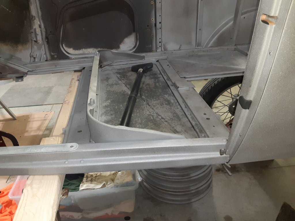

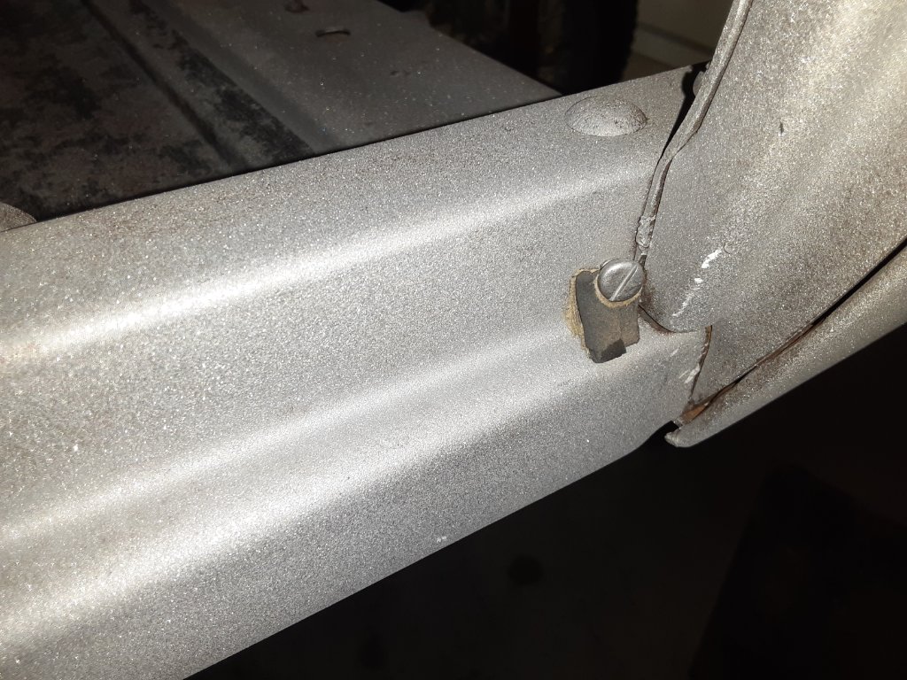

Attached are two photos of the left door on my 1927 coupe. What is this in the lower corner of the door? I had not noticed it until the body was blast cleaned. It is also on the other door.

Looks like the remains of what was once an original door bumper/support

I believe Scott is partially correct -- that was holding a rubber piece to help the door not rattle etc. But I suspect that was likely installed by a modern owner.
But looking at the photo the screw looks like a modern cadmium (?) plated sheet metal screw and not a screw from 1927.

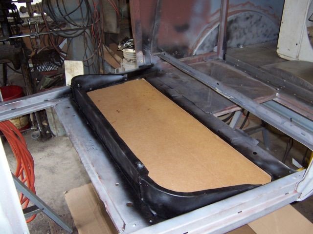

Also below is photo posted by the late Leon Parker when he was restoring a 1927 coupe. (Original posting is located at: http://www.mtfca.com/discus/messages/29/31535.html and if you find a similar number on your coupe seat area please let us know.)
Note I do not see a hole where your screw is located.

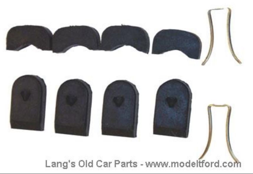

The original or closer to original style door bumpers for the 1926-27 coupes (and Tudors) are shown in the photo below which is from the Lang's Catalog at: https://www.modeltford.com/pl.aspx?t=s& ... 0NS&page=1

I don't recall ever seeing a panhead screw on a pre-war car.

Pat is correct. That is a pan head screw, a more modern item than a T. They are usually self tapping, requiring a small hole drilled before screwing them in.
