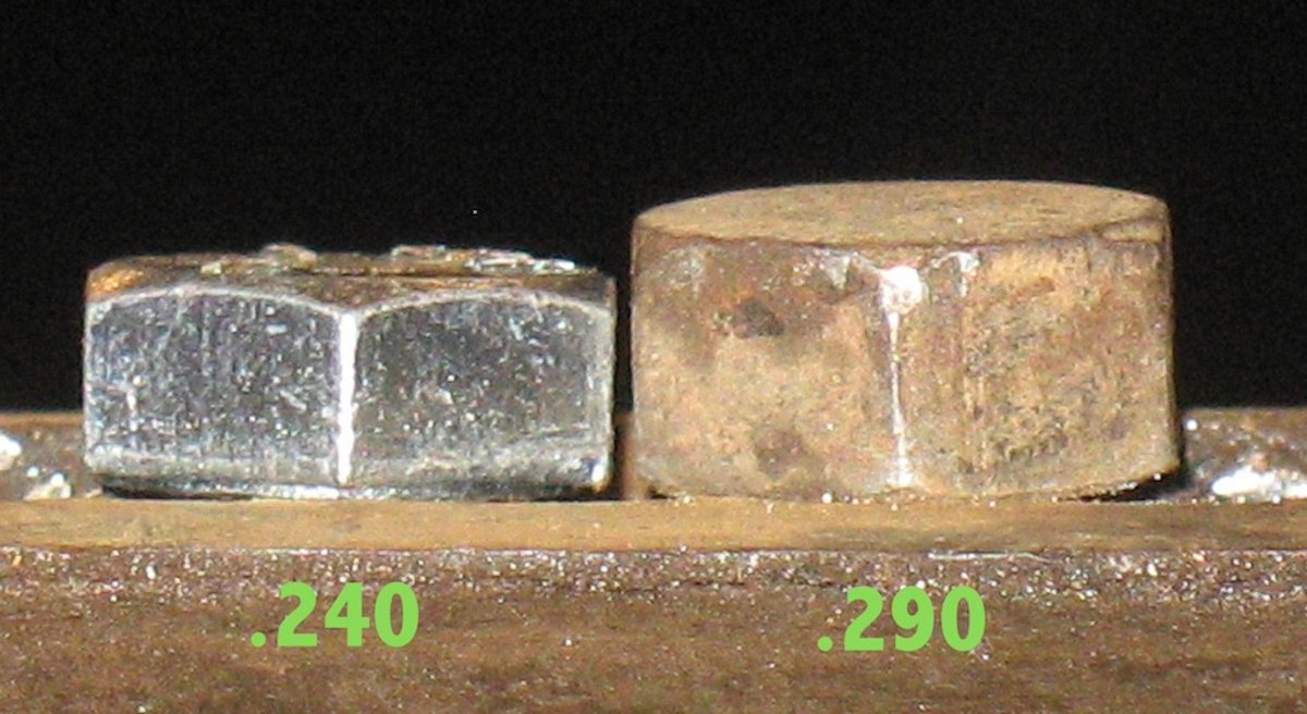

I have often used modern bolts when I didn't have originals. That requires grinding and buffing away the modern markings, drilling cotter holes, stripping off the cad plating (paint won't stick to it), painting, and baking. But the cognoscenti will spot them because the modern heads are shorter. That's why I watch for cans of original hardware at auctions and swap meets.
