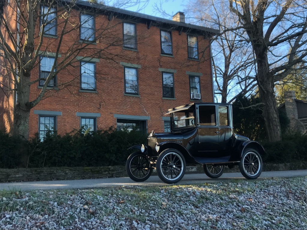

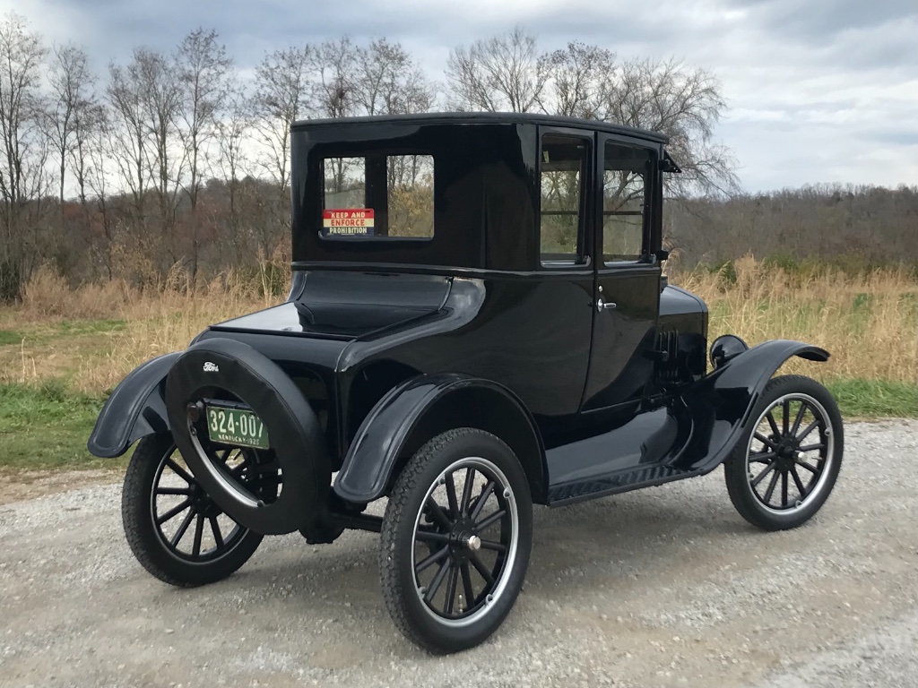

Excellent beautiful car!

I agree with Nathan....what a beautiful T!
