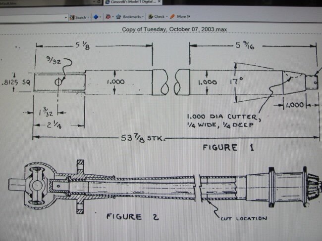

I saved this from the forum, but I do not remember who posted it.

Thank you for the drawing. Probably will be useful in the future!

Thanks, thats very useful. More than I needed. Good to print & file away.
Interesting : u - joint pin hole 3/32? S/B 1/4"

John, the U-joint hole is 9/32".

I see. For some reason my work lap top shows it clearer than my home unit. Thanks

Actually the pinion taper is 3½" per ft on diameter. This taper has an included angle of 16.594 degrees.
