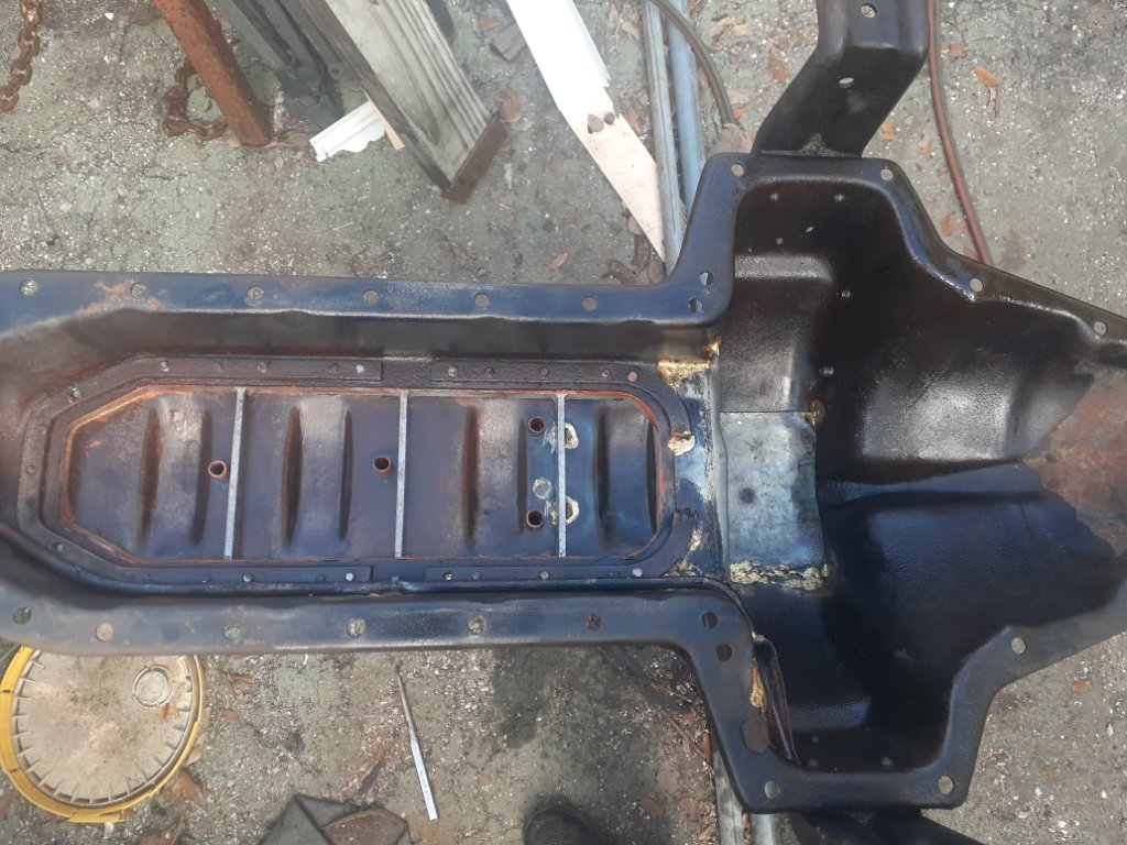

I drilled and fit a Dan McEachern deep sump to a 4 dip pan, with spacer, running an A crankshaft .I put 4 - 7/8 inch stand pipes in the intermediate dip plate, and a 1inch dam at the rear of the pan.
I'm concerned that could increase oil consumption due to excessive splashing.
Appreciate all input.

My thinking is the height of four stand pipes will control the amount of oil on dip plate, irregardless of the one inch high dam, therefore shorten stand pipe height resulting in less oil on dip plate.
Thanks for all input.

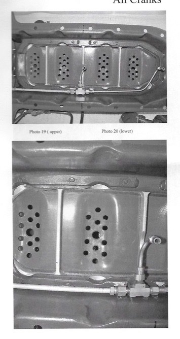

Post by Henry K. Lee » Wed Dec 15, 2021 4:54 pm
For full oil pressure on mains and rods, here's the ticket on a deep sump!
