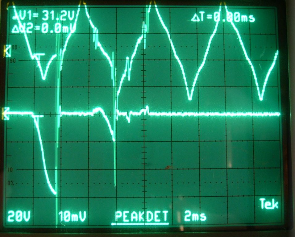

Nope, the magneto output waveform taken on my 1927 Touring looks like this:How would the magneto output look in an oscilloscope trace? Like a sine wave? i.e. AC?
The upper trace is the magneto output voltage (20V/div) applied to the coil and the lower trace is the coil current (2A/div). The voltage waveform is triangular. The spark lever is set such that the coil is operated on a single NEGATIVE magneto voltage pulse. Note how the voltage amplitude is attenuated as compared with the other magneto voltage pulses. This occurs due to the magneto internal resistance in which voltage is dropping as the coil current ramps up to ~6A when the coil points open and spark fires. Also note that there is a time between the Negative magneto voltage pulse when the coil current begins flowing. This time lag occurs due to the coil inductance property causing a phase shift between the magneto voltage and coil current. This time lag is the reason why the magneto coil ring is advanced (shifted) with respect to the crank shaft (piston TDC position). The amount of time lag changes with engine RPM so the amount of advance is a compromise for overall performance. The value was chosen of 7 degrees per Ron's excellent article on the Model T Ford Ignition System & Spark Timing.
Back to describing the waveform above: Spark fires when the lower trace coil current abruptly drops to 0A about 2ms after it began charging (Quiz question: does that TTF of 2ms ring any bells?) Note that there is no coil current or spark firing during the next positive magneto pulse; why is that? Because the coil points are still open from the 1st firing. The points close as the 2nd pulse (positive) is ending and the 3rd pulse (negative) is just beginning so the coil current only ramps up to ~2A and fires a weak spark of no consequence since combustion has already occurred. The timer roller/brush/flapper moves off contact and there are no more coil charging events for the remainder of magneto voltage pulses.
More information on how the Model T Ignition system works and the TTF method of adjusting coils covered here: https://youtu.be/RYcGD-8Ol3s?t=357

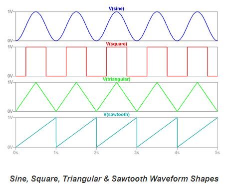

That's a sawtooth wave, not a sine. I suppose that's due to the peculiarities of the T magneto construction.

Nope. Here are the differences between the various waveforms. Which one comes closest to the actual measured magneto waveform?That's a sawtooth wave, not a sine.
The coil current waveform is actually a parabola (i=v^2) in response to the linear ramp of the magneto voltage change applied to the coil (inductor).
Yep!I suppose that's due to the peculiarities of the T magneto construction

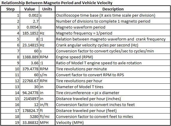

Mr. Kosser,
Thanks for posting the oscilloscope display. If my interpolations, extrapolations, and arithmetic are correct, he dwell time is 2 millisecond and the crankshaft speed was about 1400 rpm, equivalent to 35 mph vehicles speed .
1. Is my analysis correct
2. If the dwell was set at 5 ms, wouldn't the coil output be compromised.
Art Mirtes
Art Mirtes

Re: Adjusting buzzer coils
Who?Mr. Kosser
Yep1. Is my analysis correct
Yep2. If the dwell was set at 5 ms, wouldn't the coil output be compromised.
Just in case in the off chance this affirmation is not not already intuitively obvious to most casual observers, I offer the following for your consideration.
