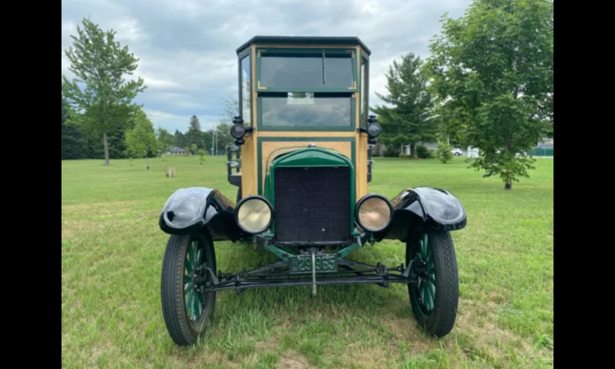

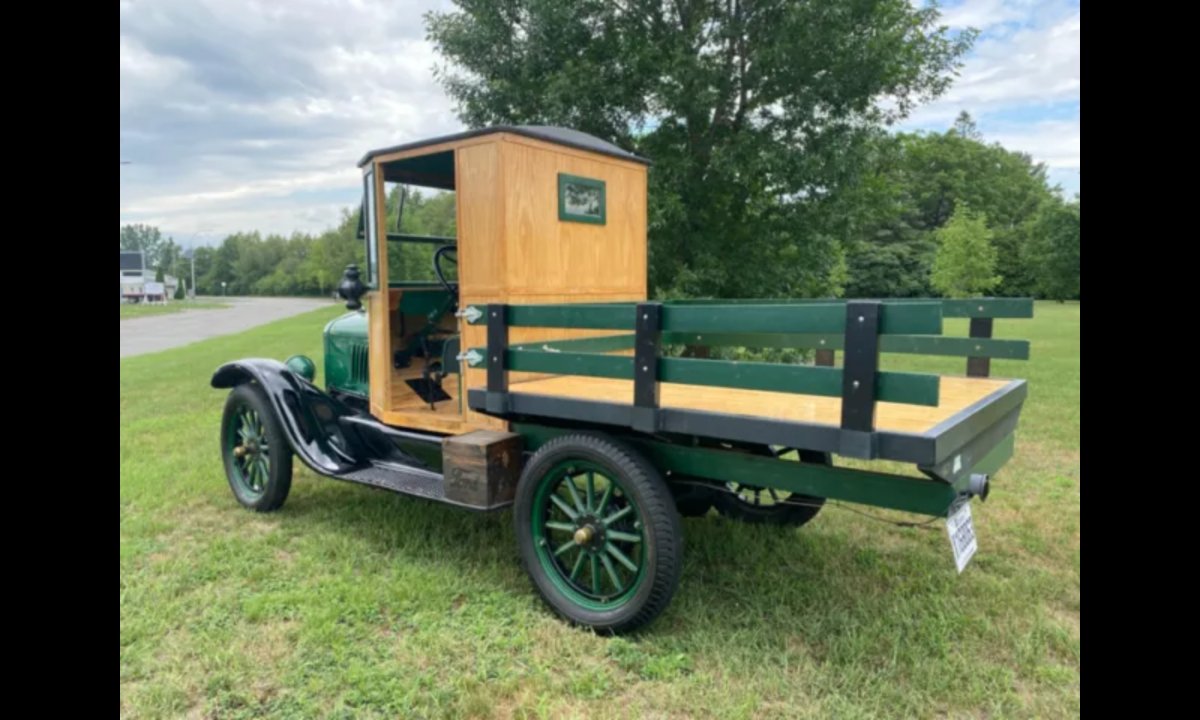

Well, the cut touring being no more for sale I still look at what's for sale not too far. There is this nice looking wood body truck. Actually fully registered and plated in my province so it would be a easy buy. Almost twice the price of the cut touring but condition is also very different. Almost TOO nice. Listed as a 1921. I don't know the serial nunber.
Tell me what you think and what would be a market value.
Thanks!

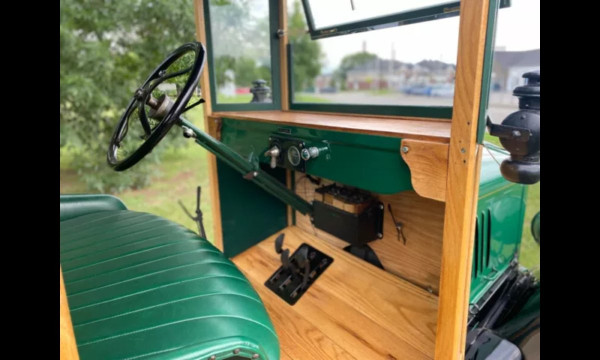

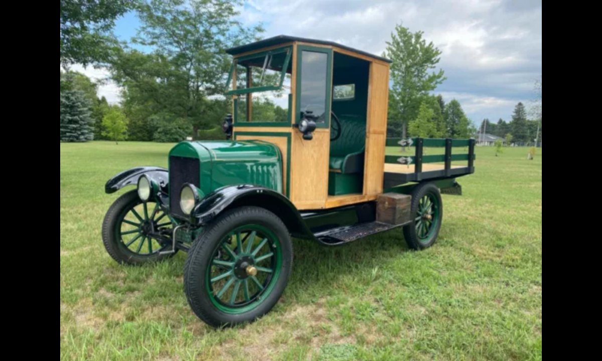

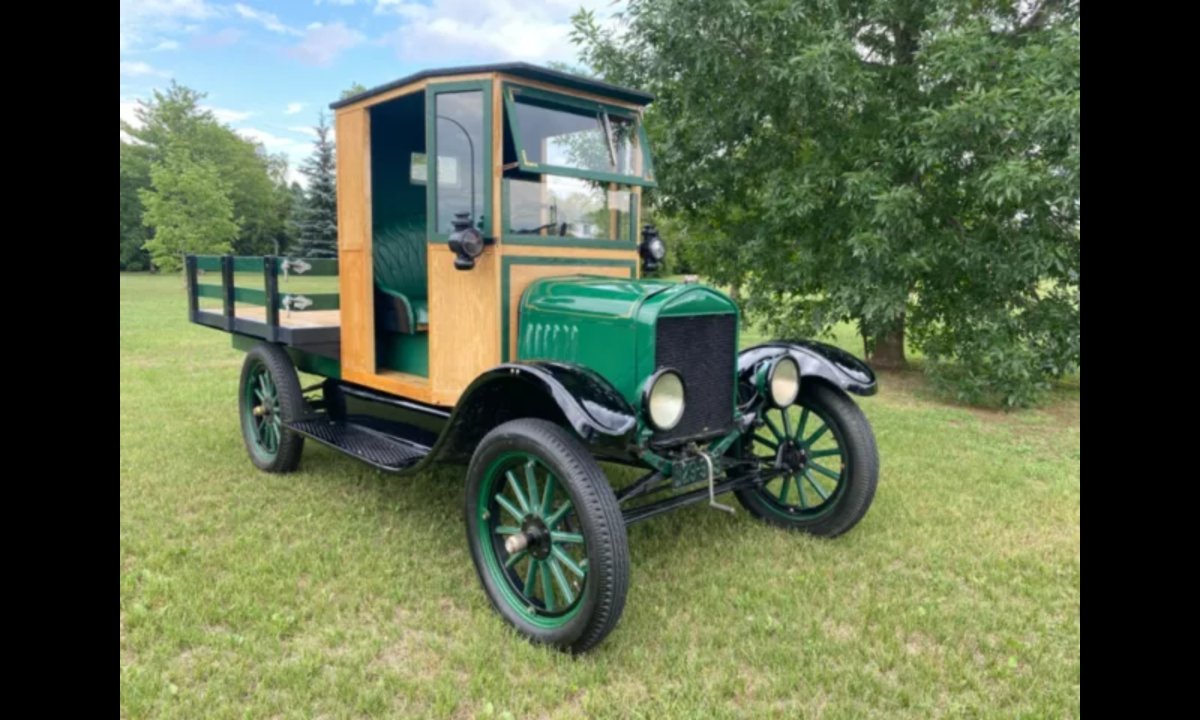

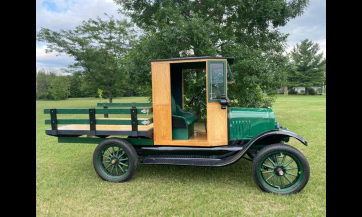

Very nice looking vehicle and appears to have been put together with considerable care. It's a home made thing though, which will limit it's resale value. If that is of no concern, and you like how it looks and drives, then whatever you decide to pay is fine. As for value, that's for others to advise.
Posts: 2990
Last Name: House
Re: Opinions on my T search
Post by George House » Sun Dec 19, 2021 6:17 pm
Clean as a whistle 😁 I like the black felloes and green rims. Has a real rare nickel 1919 ignition switch. Like Scott said, it’s a put together vehicle but real nice cabinetry work so value is indeterminate. The rear window appears to be a frame from a TT enclosed cab. If acquired, you might consider expanding that rear window for safety sake.

My questionnjng is "did Ford sold a lot of "chassis" that owners could built what they wanted ?
I also see it as a home made thing. But there seem to be a lot of them for sale.

Model T’s come in so many configurations and levels of rebuild a set price is hard to determine. Unfortunately many older cars I have looked at over the years had tons of money spent on a beautiful exterior with little or nothing done to the engine and drive train. Shiny paint does not always equal a great driver.
All in all the final price is determined by how interested the seller wants/needs to sell the vehicle and how interested the buyer is in purchasing the vehicle. When you really see a older car that peaks your interest it is hard to not buy it without keeping your emotions in check.😊
P.S.-It really needs some side mirrors for safety…..

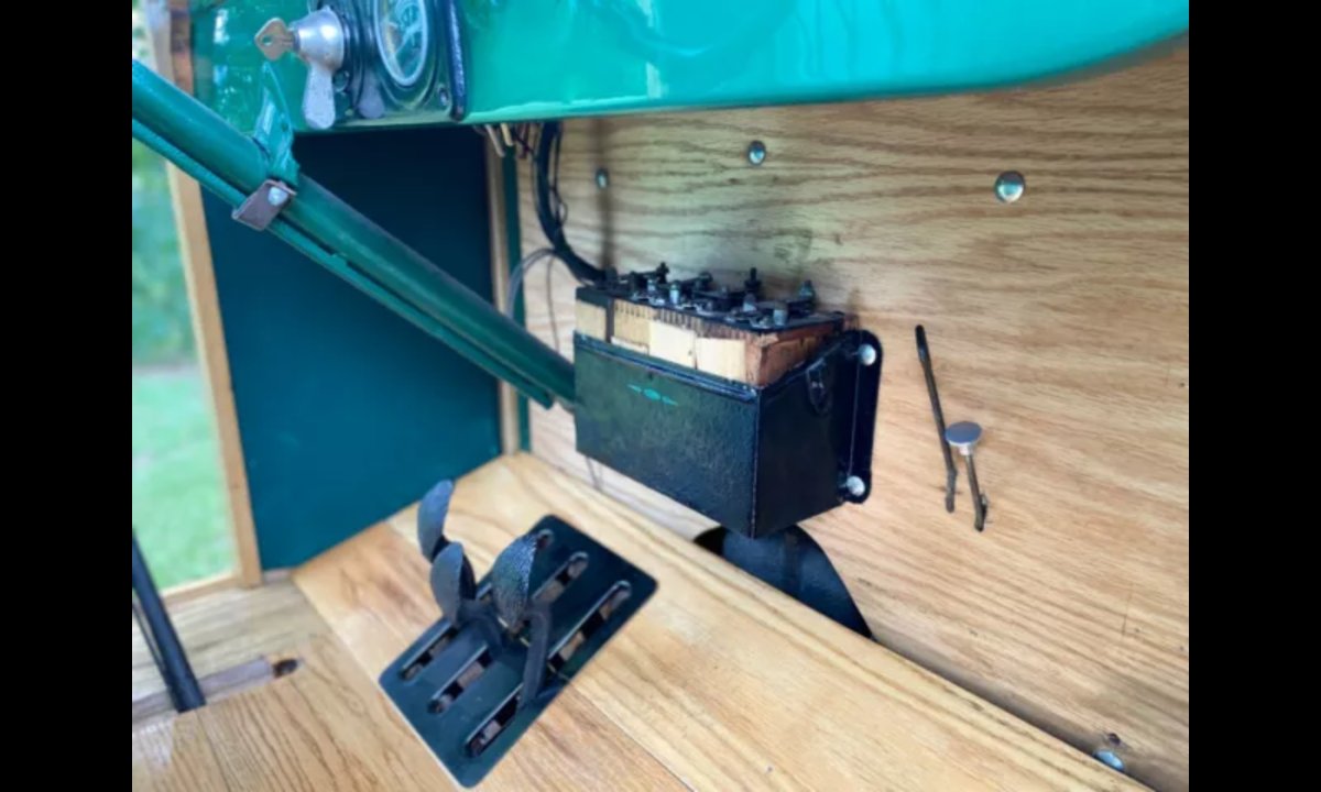

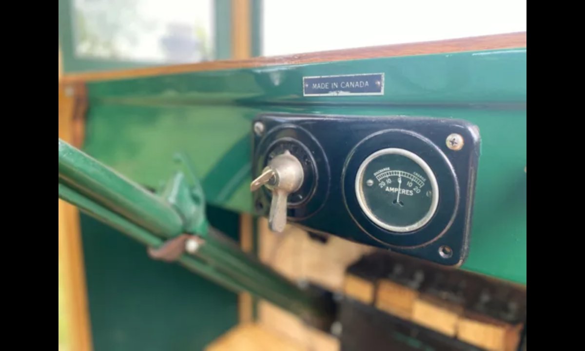

A beginners T question but were the Phillips screws used in the Ts ? My guess is NO but I now nothing about it.
Anything old and American has flat blade screws from my experience.

Your guess is Right !

You may find Robertson screws in Canadian built T's (and A's) but not Phillips

My advice for a first time model T buyer is to stay away from a TT, a bittsa/frankenstien built up from parts, and a touring cut down pickup.
The pictures you posted are of a bitsa car, made from a bit of this and a bit of that. Home made body and a mish mash of various years and parts.
The reason I recommend avoiding a TT ton truck, is that they are big and usually do not fit in a normal garage, and they were designed for a top speed of either 17 mph, or 25 mph depending on which rear end is in it. Sorry, dont know the kmh conversion, but it is painfully SLOW In any units of speed.
Learning to start, drive, and maintain a model T is a different experience than a conventional antique car. Doing it with a non-standard model T makes it harder and may put you off T's forever. A standard out of the box model T will have fewer variables to deal with. Nice model T's are inexpensive and plentiful. Take your time and pick out a good one. It is eady to fall in love and adopt any model T at first sight, so try to be objective and patient. Model T Fords are an old man tightwad skin flint hobby. The sad reality is they are all dying off and thier pride and joy's are flooding the market. Prices are falling and quality of available stock is rising. Get a good one, leave the TT's, Bitsa parts cars, and cut down tourings to the uninitated suckers. I say this as a prior or current owner of a TT, and a couple of bitsa model T's. I have been doing this for 50 years, so qualify as an old fart skin flint tight wad with one foot in the grave and one foot on a banana peel. My estate will be selling off my treasure someday at discount bargain basement prices too.

I think it’s ugly. Awkward proportions: bed too long and cab like a shipping crate. Wood finish like no T ever, modern fasteners. Did the builder really paint over the front license plate?
As opined above, often the shinier the finish the crappier the mechanicals. I’ve seen it too many times. No photos of the engine compartment is a red flag. If the seller is pitching ‘low miles’ there’s probably good reason it’s hardly been driven.
No way, in my opinion, is this thing twice the value of a running, complete cut-down pickup. Whoever buys it will find it a tough resale, and few people already in the hobby would give it a second glance.
I gather you’re just getting started with Ts. There’s lots of them out there and you would be well served to keep looking.

My thoughts echo those in the above post. I will add that the Timberlake does look to be well done, but the crude design does not do it justice.

I like it and if you also do like it, go for it. If it runs as good as it looks, you might have less to spend than if you bought a rougher car and needed to do a lot of work on it. It could be a 22. Do you know whether it is a low radiator or a high radiator? A low radiato rwould be 22 and a high radiator would be 23-25. However the fenders are 26-27. The chassis looks like a car, not a TT. But it looks good just as is. The engine number could be any year. That car is not made of parts from several years with the wood work home made. You can not tell what year a car is by the engine number, because over the years many engines have been swapped. Sometimes the engine number is changed on the registration when the engine has been replaced. Other times the number is ground off and the original number is stamped on a block manufactured another year. If you buy it, don't worry about it. Just register the same year as it is currently registered.

The first T you looked at would be the one I would have bought if I would have a choice between it and the T truck you just posted.
The first T looked more authentic to me than the Truck. The truck looks OK but in the long run you wouldn’t be happy with it. It does a variation of to many T parts for me. But that’s just and opinion.
A Touring or any other of the T cars that are out there for sale would be better and easier to drive around than this one.
This is my opinion of course and my preference.

My wife would say, the cab looks like someone nailed a bunch of 2 by 4's and plywood together.
Phillips screws became commercially available in 1936. Keep in mind that electronic ignition became available in about 1975. But the screws are more visible and don't do anything a slotted screw won't do. Electronic ignition and alternators have some merit even though not correct.
The value of this truck is in the fenders, chassis etc.

Posts: 8394

The green truck looks to me like a TT body on a T chassis. It looks rather odd because the wheelbase is too short. I believe it would look good on a TT chassis with the cab exterior painted.

I also think it look odd. The box is too long behind the wheels. It is also too nice for me. The only attractive side of it for me is it is very close to me and already plated in the province and ready to use.
Yes, as I said earlier, it's not a TT. It isn't even a TT body. Just a made-up thing.

One thing the green truck has going for it is room for the driver. Of course that contributes the the extended rear. With a heavy load too far back, I can imagine the thing with its nose in the air like a clown car. :D
