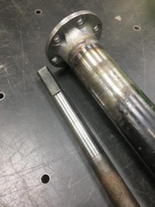

The way to weld the tube back together, is to assemble the D/S & bolt the spool on before welding back together. This will insure the PERFECT alignment necessary. I have seen a few "professional" conversion jobs where when assembled binded from misalignment. One was off so far as to eventually shear the drive shaft.
Shortening the D/S & re machining the square end is a high school level machine shop project.
Any local shop should be able to do it. Cutting down the other end takes a bit more precision & operations.

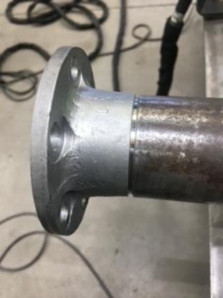

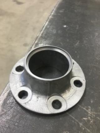

My nephew has done a couple of these, said that machining a new shaft is less of a issue than a old one. I have seen alot of tubes shortened by just cutting & welding and some that are not real straight. This is how he does it.
drive shaft.jpg (16.76 KiB) Viewed 2095 times

I have a good size lathe so I can turn down the flange and tube as shown above. I don’t have a mill in the shop, I use a friends but I have to drive an hour. I could do the work on the shaft but if I can have it done for a reasonable price, I would do it.
