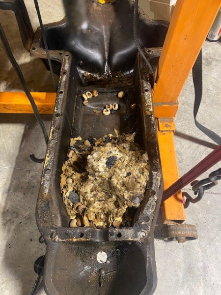

This is my first T engine tear down and it gave me a good chuckle so I thought I would share. Anybody else ever have a mouse house inside the pan?

Anyway I got the engine up on the stand and dropped the pan and this is what I found.....

Just be very careful and probably wear a mask as there is a fair risk of contracting HANTAVIRUS!

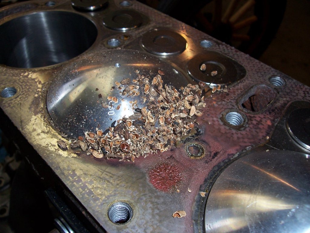

Yes, I had that too on a spare engine. It must have gone in thru the oil filler cap opening. Ruined the crankshaft.

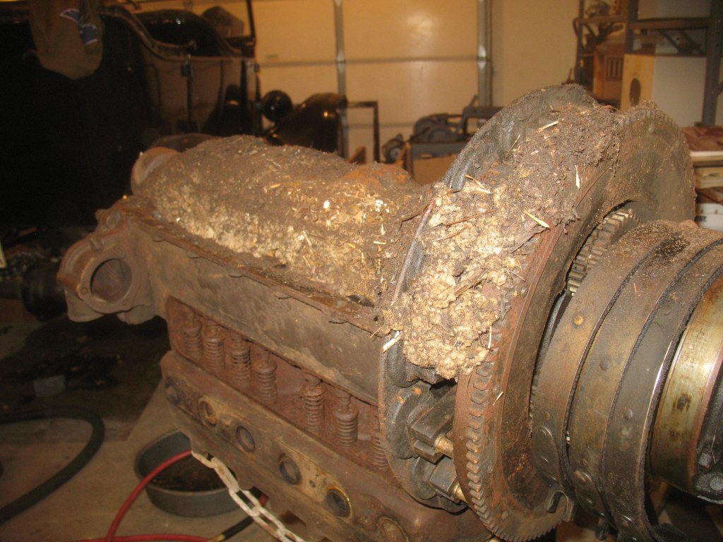

Discovered this in a freshly rebuilt engine that sat for several years - I won't "start" anyone's engine that been sitting for a spell without head & lower pan cover removal - not much into "surprises" !

This engine came from a barn in Michigan and was sealed up except for the starter and generator holes. The car I bought out of the same barn was ankle deep in nuts and mouse debris so shouldn't be too much of a surprise I guess. I have a couple radiators I picked up and it looks like they were knitting sweaters inside of them, industrious little bastards.

Thanks for posting this. It would seem good to me for anyone who is going to install an engine which has been setting around, or even one in a car, unless everything is closed, to remove the inspection cover under the engine and over the transmission and be sure everything is clean before starting. Crankshafts are expensive and could even plug the oil line with debris and ruin the whole engine.
I haven't done that in the past, but only used one rebuilt engine which I bought at a swap meet and was lucky. All others I have installed have been recently pulled apart for repairs.

I didn't try to start this one.

Steve that's a different form of oil dry right there! Wonder if oil in pan would discourage them?. There was just a touch of oil in mine but it was back by the transmission in the sump and the nest was at the front. Steve's looks like a mouse condo community.
