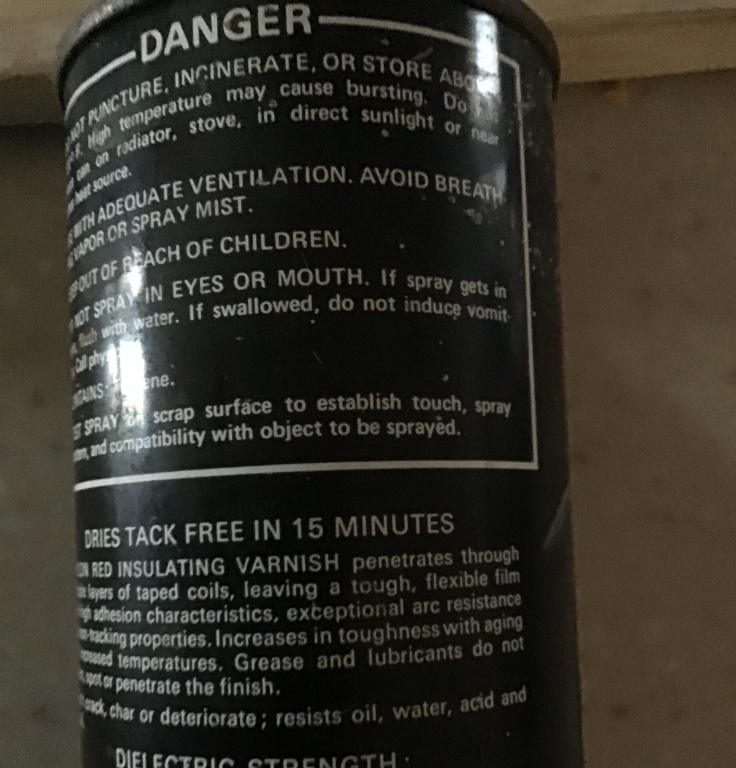

Here’s what I used in the mid 70’s. Krylon no.7004 insulating varnish and probably a form of glyptol. This can has been around 50+ years. I forgot I still had it. Then read this post and I remembered I kept the last can I had. Krylon was founded in 1947 and Glyptol was developed in the teens by GE or so I read online.
It’s interesting that Borden owned it along the way and sold its interests to others in the 90’s.
Reading the back of the can it must be some potent stuff. When I coated the mag ring on my first tare down of my 24 coupe in the seventies I sprayed it the same red color as J Bartows pic of his. It held up pretty well considering I cleaned up the mag ring with kerosene and dried it off, let dry and sprayed it! Nobody was rewinding them that Iknew off at the time.
