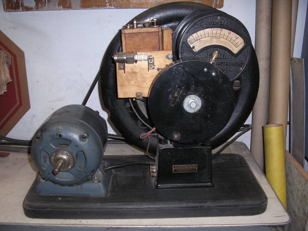

I was able to buy two Wilson hand cranked coil testers a few months ago and have them just about restored. Bob Cascisa has rebuilt and recalibrated the Jewell meters and I am anxious to receive them - promised delivery Monday by USPS. One is now complete but the other has a broken crank handle which I have not been able to replace. I have a reprinted Wilson catalog that shows the testers with the crank and with a vintage 1/4 hp electric motor. With the correct motor I will have the set so am going that direction. Do any of you know what make and model of motors might be right to use? Pics to follow.

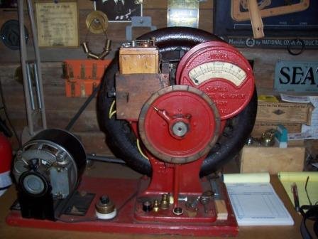

Re: What am I looking for?
I have an original KRW electric motor driven coil tester - photo is in Bob's great book ! It has a G.E. motor - I'll get back to you on the particulars.
Steve, Thanks for the reply. I was pleasantly surprised that the pic you posted was painted red. Both of mine appeared to be red originally so that is what I repainted them even though some forum posts suggested otherwise. I need to get Bob’s book, what a gentleman to work with!

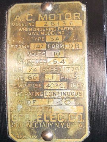

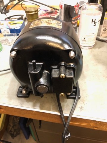

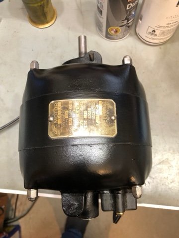

KRW used a G.E. of Schenectady, NY, electric motor to drive the flywheel. It is ¼ HP, 1725 RPM.
