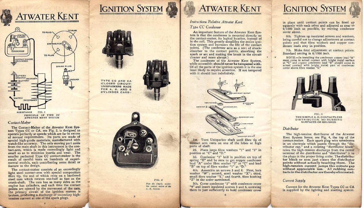

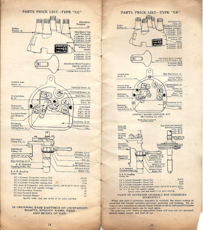

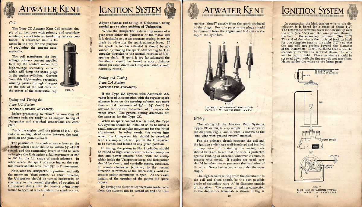

Post by TRDxB2 » Tue Dec 21, 2021 8:42 pm
I believe these instructions are applicable even though you have a Bosch distributor.
Pages 8 -13 are the important ones.
Click on a picture to make it larger
