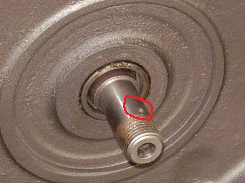

are you saying that there is absolutely no hole drilled 1/2 way through the cam per this circled feature below?
timer pin hole on camshaft.png (286.47 KiB) Viewed 3816 times

Ford cams never had a keyway in them. The hole was in all factory cams to locate the timer brush. Atwater Kent Clip on distributor drive gears have no provision for a key or the pin and rely on the timer brush nut to prevent the gear from turning. One version of Atwater Kent front plate used the pin hole and pin to locate the drive gear while another version used nothing. The Bosch clip on distrubutor drive gears have a keyway that the pin fits in to locate the gear, but again, the timer brush nut provides enough load to keep the gear from spinning. You cam should at least have the hole.

Thanks guys for all of the information. It was really helpful. I am using a Bosch magneto set up introduced in 1914 that has a large gear that fits where the timer was, an idler gear, and the third gear drives the magneto which sits where a generator would be on later cars. The gear that fits on the camshaft is broached for a key. On further inspection, there is a pin in the camshaft, half-way in as you suggest, sheared off. The gear on the camshaft therefore has at present nothing to prevent it from rotating on the shaft which would of course affect the timing etc. I do not want to remove the camshaft to broach for a keyway. Can the camshaft front nut really be tightened enough to prevent the gear from slipping on the shaft? When I check it when the motor is cranked clockwise the gear seems to check securely on the camshaft, but will "spin" without engaging on the camshaft when turning the gear in the opposite direction via the mag gear/idler gear?!!?!?! What are your suggestions for securing the large gear to the camshaft? It does not have a lot of pressure/torque applied to it since it only has to run the idler gear and mag drive gear which offer little resistance, but the pin that presumably fits halfway through the camshaft appears to have protruded into the broached keyway on the driven gear and got sheared off. Any and all help/advice/suggestions will be gratefully and heartily appreciated.

I would either very carefully measure the dimension from the seating face for the roller/flapper, to the sheared off pin, or better yet contact STIPE and say "pretty please" and get the mfg value. Follow up with a precision sleeve with cross-hole for a drill guide and peck it out. You may not THINK there is much torque there with the gear, but I'm betting that's all that was indicating the gear in the first place and there is in fact a good deal of torque transmitted.
Better yet and if it was my car, I'd remove the cam and put in a proper woodruff seat after the pin was out, using the pin hole as my groove datum.
