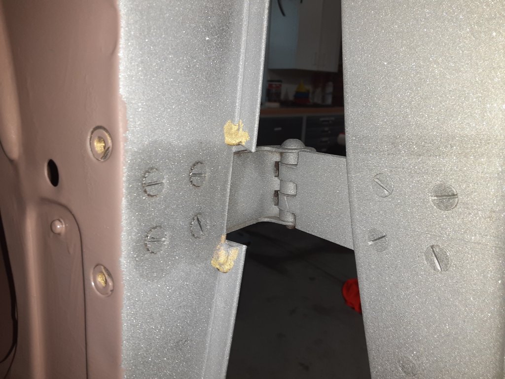

I knocked the pins out when I restored the fordor, but now the pins stick up a bit since afraid to pound them back in and removing the paint So is it a good ideal or not?
Posts: 7657
Re: Removal of Model T Door
Post by TXGOAT2 » Tue Dec 21, 2021 10:04 am
Not a good idea. Maybe you could use a C-clamp to push them down. Glue some hardwood pads to the C-clamp and tighten it on the pin, then tap the handle end of the clamp screw lightly with a small hammer. The pins need to fit snugly. New paint will usually cause some binding. If the pins were knocked out, the hinge parts may not be aligned exactly. If that's the case, finding some rod the same diameter as the pins and grinding a taper on one end and working it into the hinge can be helpful. It's not likely you'll end up with perfect paint on the hinges. Having the door partway open may make the pin easier to install.

I have a coupe and a fordor so i bought a hinge pin remover from Snyders, it takes them out with little fuss and pushes them back without taking the paint off.
Rick
