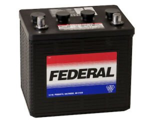

Kerry
Posts: 1463
Last Name: van Ekeren
Re: Do you use 8 volts?
Post by Kerry » Thu Dec 23, 2021 10:42 pm
John, A place in Sydney lists the Federal brand on Ebay, more than 10 in stock, I had one of those last more than 12 years.
