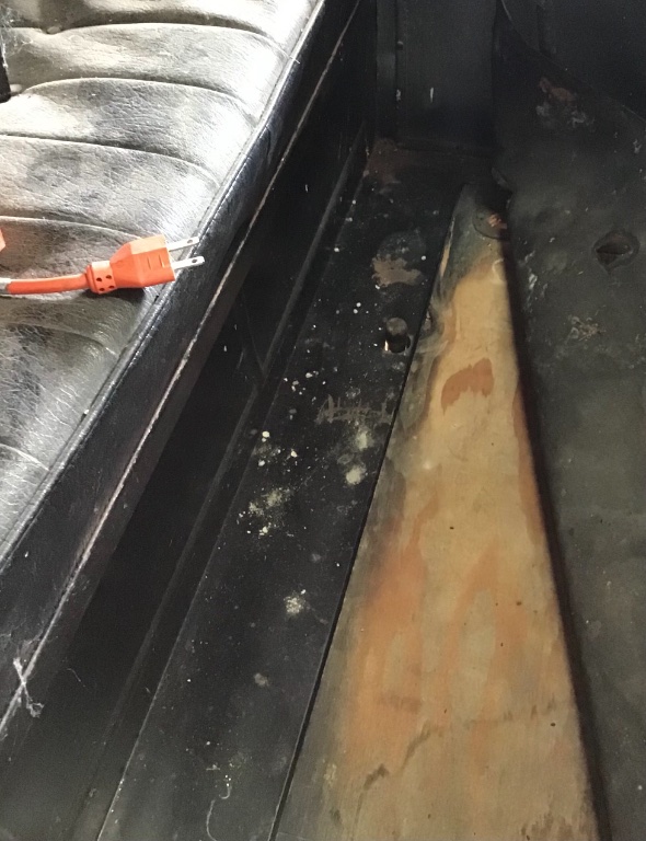

Here is a pic of my 1919 Roadster with starter. The metal panel is directly in front of the front seat and is separate from the body as I remember. My car is essentially the same as your 20. The panel is called the heel kick panel I think. You can see the starter button.

There is no need for a special plug for a remote battery charger. The battery under the seat, next to the fuel tank just sits there. I charge it when I get home again by hooking one lead on the charger to the battery terminal on the coilbox, and the other to earth on a manifold clamp.
On my depot hack, I do the same. Its battery is under the seat in the back, out of sight and reach.
