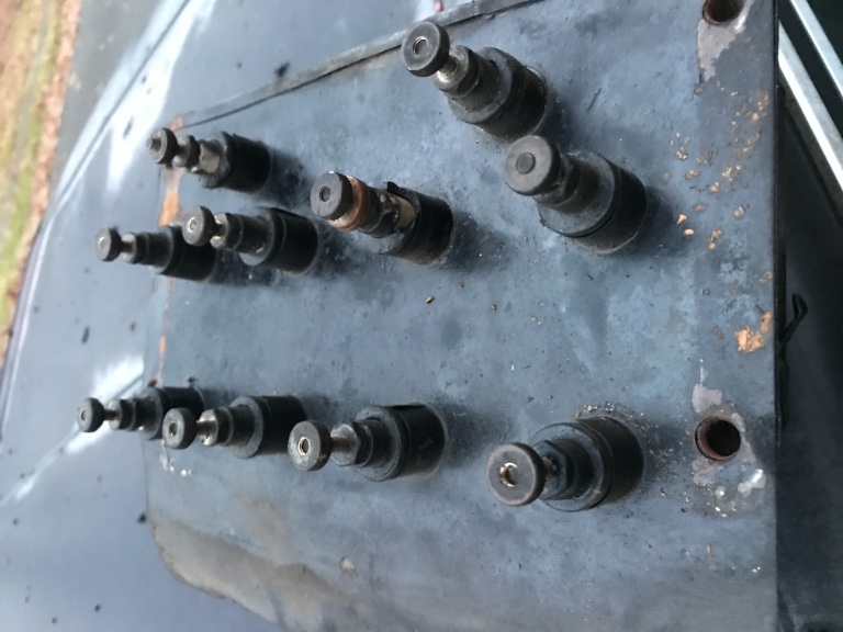

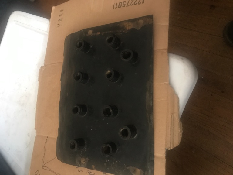

There's this tin with rubber sleeves between the coil box and firewall--- I don't see parts to replace the rubber, is it something I should leave out?

Throw the "tin with rubber sleeves" in the garbage. Has no place on a Model T.
Edit: Sorry if that sounded angry or abrupt... As Scott suggests below, leave it out for now. Like your accessory timer, it's a variable that you don't need right now. Get everything "back to basics", with a known good set of coils and go from there.

If the rubber insulators are old, they have likely lost a portion of their insulating properties. If they were ever run wet or dirty, they may be carbon tracked. Most black rubber contains carbon black, which is a conductor . Carbon black does not decay, but rubber does, and old rubber insulation might be expected to have poor insulating qualities at high voltages, even if it's never been used.
