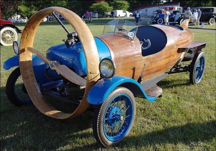

Re: Texas Inspector Threw the Book At Me.
Wouldn't you love to be a fly on the wall, when the inspector is presented with this?

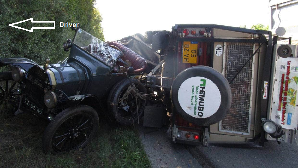

Frank, the picture you used in your post is of this very nice Dutch couple, the picture is of the accident they had when hauling their T on a trailer behind the Landrover support vehicle.
On a side note; the windshield is safety glass
The T was rebuilt and they are still traveling with it !
https://www.tfordworldtour.org/nl/
Leo van Stirum, Netherlands

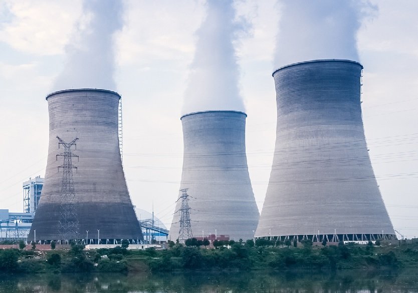

- Posts: 6607
Thank you for the description and the link to the happy couple. NOTE: The cooling solution! All I did was mention seat belts in my text, showed a crash and pointed to where the driver was (standing?). Then others made their own conclusion.Kaiser wrote: ↑Fri Jan 14, 2022 11:09 amFrank, the picture you used in your post is of this very nice Dutch couple, the picture is of the accident they had when hauling their T on a trailer behind the Landrover support vehicle.
Its much like the News Media discussing Air Pollution and showing pictures of cooling towers dispensing water vapor into the atmosphere. A picture is worth a thousands words but the words accompanying them may not always be in agreement.

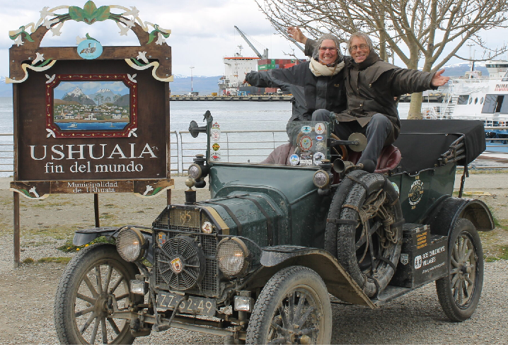

I wonder what the translation of that sign is? The lower part "del mundo means "of the world in Spanish. I wonder what it means in Dutch?
DLodge
- Posts: 613
- First Name: Dick
- Last Name: Lodge
- Location: St. Louis MO
Norm, the couple is Dutch, the sign is Spanish. Remember they toured through much of the world in that car. (It was even here in St. Louis.)Norman Kling wrote: ↑Fri Jan 14, 2022 4:30 pmI wonder what the translation of that sign is? The lower part "del mundo means "of the world in Spanish. I wonder what it means in Dutch?

- Posts: 6607
fin del mundo; Dutch einde van de wereld; English end of the world.Norman Kling wrote: ↑Fri Jan 14, 2022 4:30 pmI wonder what the translation of that sign is? The lower part "del mundo means "of the world in Spanish. I wonder what it means in Dutch?
Ushuaia has long been described as the southernmost city in the world. While there are settlements farther south, the only one of any notable size is Puerto Williams, a Chilean settlement of some 2,000 residents. As a center of population, commerce, and culture, and as a town of significant size and importance,[26] Ushuaia however clearly qualifies as a city. A 1998 article in the newspaper Clarín[reported that the designation "Southernmost city in the world" had been transferred to Puerto Williams by a joint committee from Argentina and Chile, but this was denied by Argentine authorities,[28][29] and the Secretariat of Tourism of Argentina continues to use the slogan in official documentation and web sites.
Wonder if they went there too?
I have been to Ushuaia several times, great place. They love to camp in the forests near by in small pup tents in the summer, but there is always two inches of water almost everywhere. There are huge glaciers nearby and that is where all the ships and helicopters start out to go to the South Pole. The hotel on top of the hill is the best place to stay but the food most places is almost uneateble.
