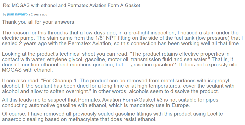

While Permatex Forma-A-Gasket is a wonderful product, today there could be a new issue.
It is resistant to Gasoline, Oil, and Antifreeze, but it is Alcohol based.
Today with alcohol creeping into gasoline there could be a future problem with using it on gas fittings.
If it is used somewhere that is exposed to gasoline keep an eye on it for possible future leaks.
Time will tell if this becomes an issue or not.
Things would be a lot easier (and smarter) if they quit using corn to make fuel.

CONFIRMED!Mike Silbert wrote: ↑Sun Mar 08, 2026 9:58 pmWhile Permatex Forma-A-Gasket is a wonderful product, today there could be a new issue.
Mike
https://next.henkel-adhesives.com/us/en ... 53476.html
Loctite 518 is highly resistant to gasoline and various fuels
.As an anaerobic gasket sealant, it is designed to create a flexible, solvent-resistant seal that will not tear or decay, making it suitable for applications involving fuel exposure.
Key details regarding Loctite 518 and fuel resistance:
-Performance: It provides excellent resistance to gasoline, diesel, and motor oil.
-Applications: It is frequently used to seal rigid metal engine casings and gearboxes.
-Compatibility: It is effective on aluminum, iron, and steel flanges.
While highly resistant to fuels, it should not be used in systems containing strong oxidizing materials, such as pure oxygen or chlorine.
- Posts: 6817
Re: Thread size for 1910 sediment bulb
Loctite 518 is specifically made for flange-type gasket creation - It is not designed for pipe fittings and thus, I would NOT use it for NTP fittings
If you simply MUST spend more money on a Loctite product, then spend it on 545 which is specifically made for pipe fittings and is fuel and alcohol proof
The added bonus to any Loctite product when used on brass, for those hell-bent to spend more money than necessary, is the encouragement to use yet another expensive product in conjunction with it - that being a Loctite Activator
I suppose it's a fact of life that much good advice on the Forum - advice with decades of use, experience, and success to support it, often has a way of becoming as worrisome as a lit fuse on a stick of dynamite. The topic then becomes centered around the imaginary dynamite. I don't know why driving a 100 year old car with no brakes in modern traffic is nothing to worry about, but the risk of a failure of a sealant is...a sealant with a nearly incalculably small area of exposure to a fluid containing a small percentage of alcohol. If that's the case, then never fear, there is an expensive, Model-T-owner-worry-resistant product called Loctite 545 as mentioned above.
In my prior posting, I mentioned that I typically use a very inexpensive tube of Permatex #2, and in 40 years have had zero failures on fuel related lines including use on Model Ts for the last 20 years during the "ethanol years". The very fact of it being cheap should appeal to most "T" owners, even if it didn't work at all. For those who equate "spending money" with "success" then as mentioned, there is always Loctite 545 which is an outstanding product which I have also used with equal success and under far harsher environments.
Lots of things to worry about in life, I suppose. This isn't one of them.
