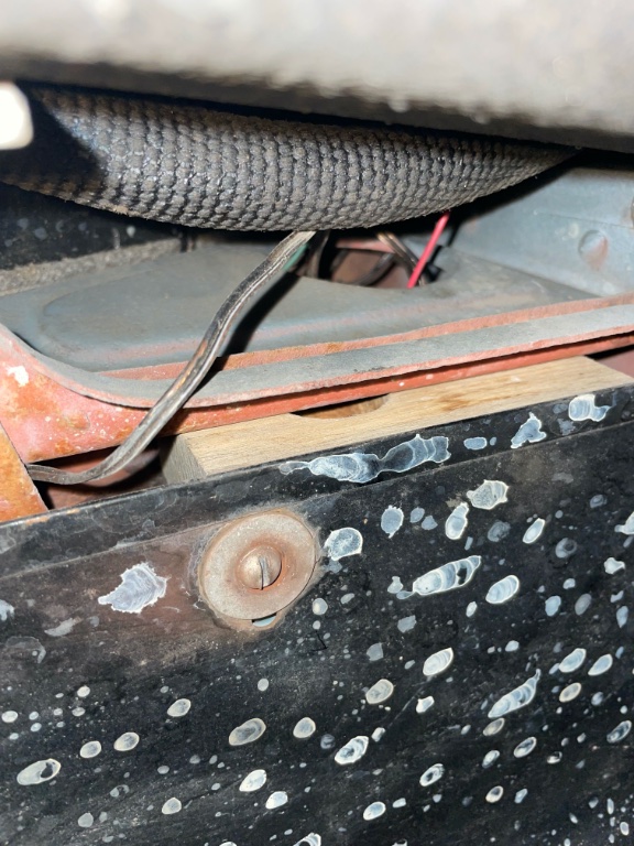

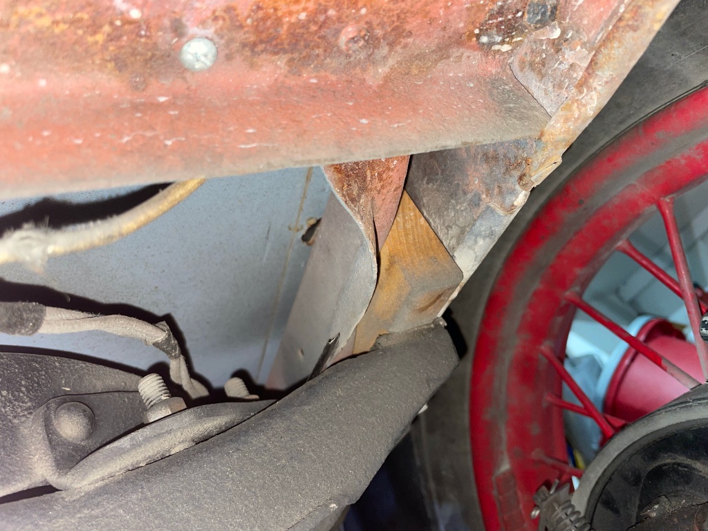

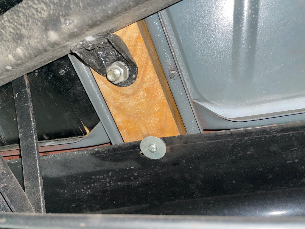

You are correct, the Touring wood block set is the A and B in that sketch. Here is photo from Lang's catalog, (cat. # 3600A) used a similar set of these pre- made pieces on my touring, but don't remember the supplier as my parts were rather plain blocks without the reduced section on thickness. Believe the reason for that end is to clear rivets on the main channel? But don't recall as I did this work in 2003!
Main body blocks, these fit into the main cross channels of the touring subframe. Rough dimensions 1 1/4" thick, 2 7/8" wide and 7 1/2" length.
Note the screw for holding the rattles of the splash shield, place that into the wood block.
Rear block, fits up inside the rear subframe rail. Rough dimensions 1" thick, 2 7/8" wide, 5" length
Front block, while not shown in the Langs catalog pic, my set had these, one on each cowl lower, that block is only there to secure the front end of the splash shield, otherwise it will droop at the fender junction, and make rattles too!
Held in place with a wood screw I remember.
Road grime under there as this is our main tour car, topside is kept decent, underside get no care :?

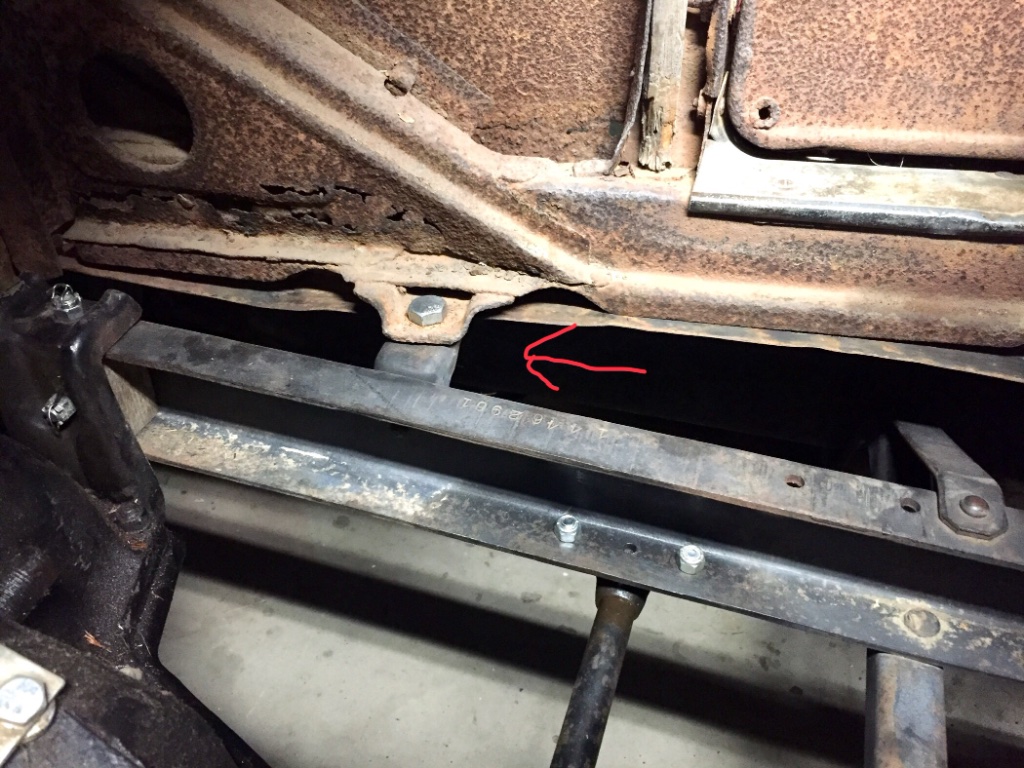

1. Should there be any spacer where the front bolt connects (see red arrow):
2. Back to my original question. Are spacers used in addition to blocks. It seems like you have one here (indicated by green arrow):

1) The front connections do not use a spacer.
2) The wood blocks are used to mount the body without any additional spacers.
If you have a bent frame, or a crooked body, you may not get things to line up. If you need to use additional spacers one or both of those problems may exist.
